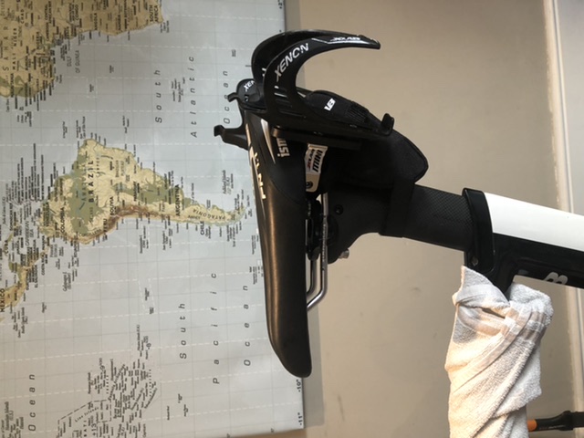

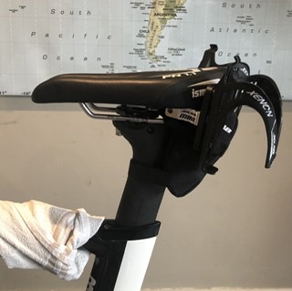

Here is mine…ISN P1.1.
Only the first saddle I bought to change from stock (felt b16). Massive improvement over stock but feel like I should be more tilted… what do you think?
what ISM says is that the rails should be level, and that means a nose-down aspect. here’s the rule, according to me: nose down as much as you can, until you start to slide off the saddle. if you need to make any special movement or adjustment while riding to keep yourself from sliding forward, then you’ve gone too far. go just that far, and no farther. stationary riding is a great place to work on that.
