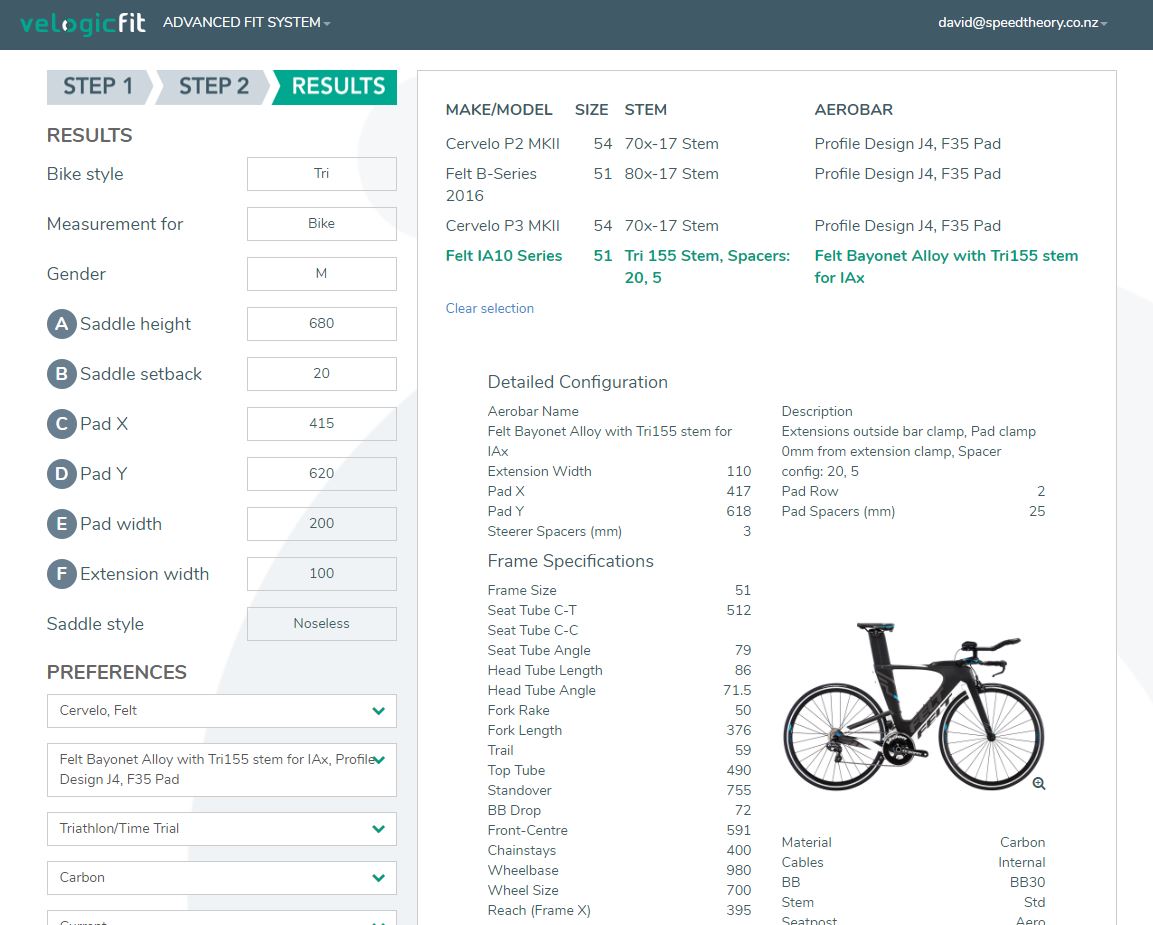

Let’s assume your position, outside of being too far forward, is otherwise pretty decent. You report a pad stack of 677 and a pad reach of 500. If that pad reach is to the middle of the pad, you can subtract 40-45 mm to get to the pad edge (which is a better measurement of position in my opinion). So now you’re at 677 and 455.
The saddle needs to come back 25 mm and that brings the cockpit back another 25 mm, so you’re at a pad reach of 430.
Since you pulled the saddle back 25 mm, you need to lower it a bit as well - let’s say 5 mm - to maintain a similar saddle height. If the saddle drops 5 mm, the cockpit should drop the same, so now we have a 672 mm armpad stack and a 430 mm armpad reach.
Using our internal fit tool that measures to the armpad edge, I’ve attached the resulting report.
Understand, these recommendations are based on several major assumptions that may not be true: 1) your initial fit is good, just too far forward and 2) the changes I’ve made won’t be destructive. Some of the bikes listed will support a steeper saddle position and a more forward armpad position, so you may very well find that you don’t have to go as far back as I did in my math. I’ve also made sure the bike choices provide you the opportunity to lower the cockpit, as I suspect a 52 mm drop might not be as low as you can reasonably go.
Our fit report also includes bike photos and details of each bike, but I had to only provide the first page due to Slowtwitch only allowing attachments of 250kb or less.
All of this is intended as a thought exercise since I can’t see whether your fit is of any quality, so please consider the recommendations list with a grain of salt.

One other note - those stack and reach ranges listed do not include possible stem changes are possible alternative configurations (such as armpads mounted directly on the base bar and an extension undermount - etc.). One of the reasons armpad stack and reach numbers aren’t reported by vendors is because there can be reasonable disagreement on two points:
How much adjustment is possible on a bike - do we consider only stock parts, etc.?How much adjustment is reasonable on a bike - just because a bike can support 10 cm or pedestals, for example, does that mean we should consider that a good fit?
We tend to be pretty conservative on these points and let the fitter consider possible adjustments based on the circumstance and budget of the fit customer.

Yes it is. Generally I’d expect that inseam to go with a saddle height more like 680mm, unless they found you some extraordinarily short cranks.
So you can see why I felt there was a contradiction.
Knocking 50mm out of the pad Y (to correspond to dropping the saddle) would make a big difference to the bikes you’re looking for. We’d now be talking about frame sizes that don’t seem so outlandish for your height. And you would have more options.

Using Trents workings about setback and Pad X, plus what I said about lower saddle and bars gives this estimated position and some bike options

I’m confused, Trent’s analysis resulted in a 56 Felt IA, and yours tells me 51? even shorter than the 52 I currently ride…?
Because I searched for a bike 50mm lower and 15mm further back than he did.
Thanks to allowing for a lower saddle height and the length of the zipp armrests that were most likely used on the DFU.
That you have a 52 doesn’t necessarily mean much. Do you know the reach of the frame?
The IA has quite high stack bars, you would be on a 54 with different bars
