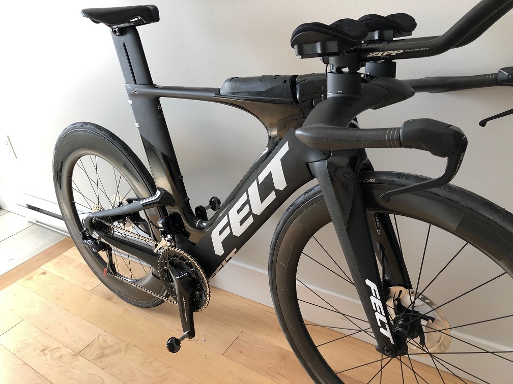

Felt Dagger Stem
Zipp Vuka Base Bar with Tilt
D2Z extensions
51SS arm cups
Cee Gees pads
Works perfect for me
That setup looks brilliant!
