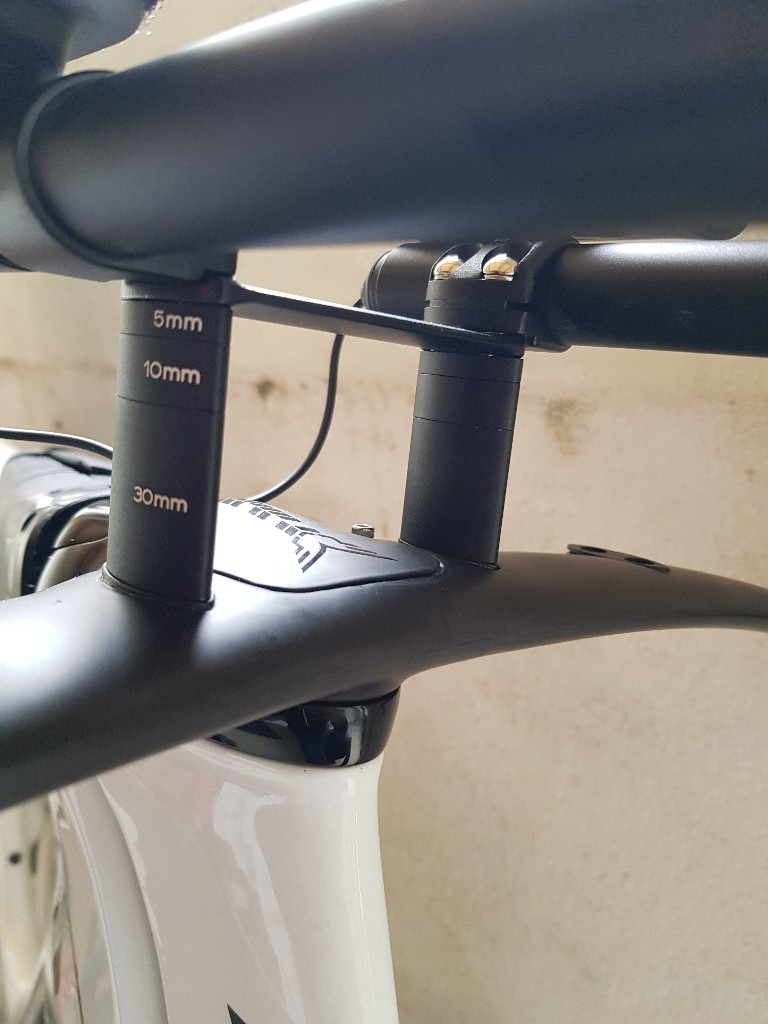

LBS did mess up a bit on the setup; amongst other things they used the wrong spacer underneath the handlebars (30mm instead of 15). I know I can change the spacers underneath the tri bars, but I want to lower the handlebars altogether and only play with the tri bars going forward - it also looks much better which is extremely important :slight_smile:
I went in to change it myself but unfortunately realised that all cables, including front brake, go through said spacer… Felt responded quickly to my request on their website, saying that I basically had to disconnect the front brake and the electric cables, swap the spacer and reconnect everything - and of course re-bleed the brake. Not something I can do myself so will bring back to the store, just thought I’d share it here in case you are building one - make sure you get this right in the first place!

I got my IA3 at home , love it :-). There is also a 3cm spacer under the base bar (I will remove that) but how many cm can I raise the earobar? Now there are 4cm of spacers. Will 7cm spacers to high?
I got my IA3 at home , love it :-). There is also a 3cm spacer under the aero bar (I will remove that) but how many cm can I raise the aerobars? Now there is 4cm of spacers. Is 7cm spacers to high?
This line makes no sense unless you mean there is a 30 mm spacer under the base bar. But if you really need 70 mm of spacers under the aerobar you are probably on a size too small , wrong bike or you need a fit :wink:

Idd I mean there is now 3cm under the base bar. And I want 7cm under the extensions.
The size is good. For now the position is relaxed. After some months I will lower the aerobars a couple of cm to get a more agressive fit. (The fit will then be the same as on my old TT bike.)

Even with 4 cm under the aerobar I would say that is on the high side and the higher it gets the less stable it feels even with the bridge.
But if you are happy and enjoy it that is all that matters :slight_smile:

Do u know if the aero bar extensions can be mounted with no spacers. Ie… flat to the base bar?
I think u need the 5mm spacer
