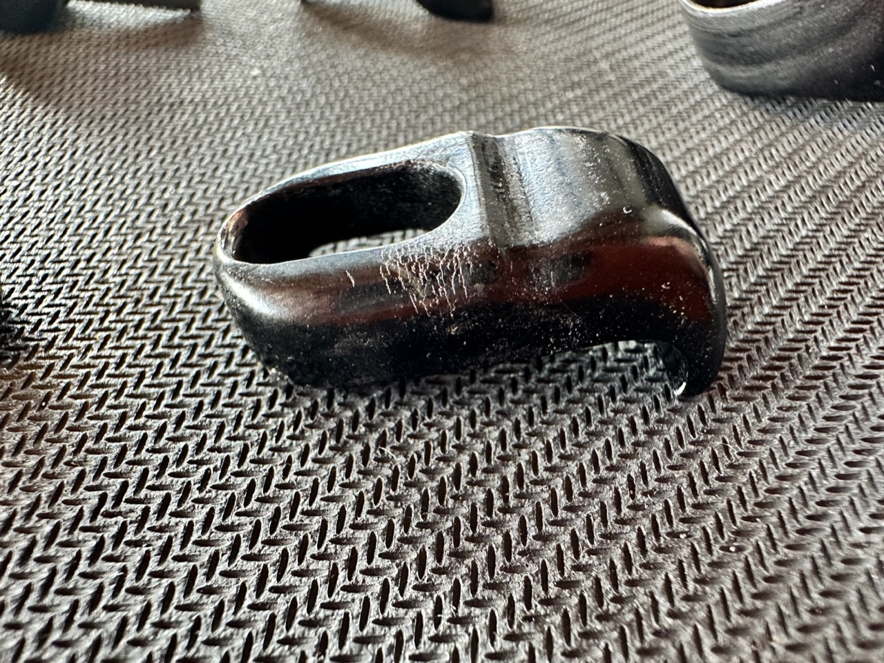

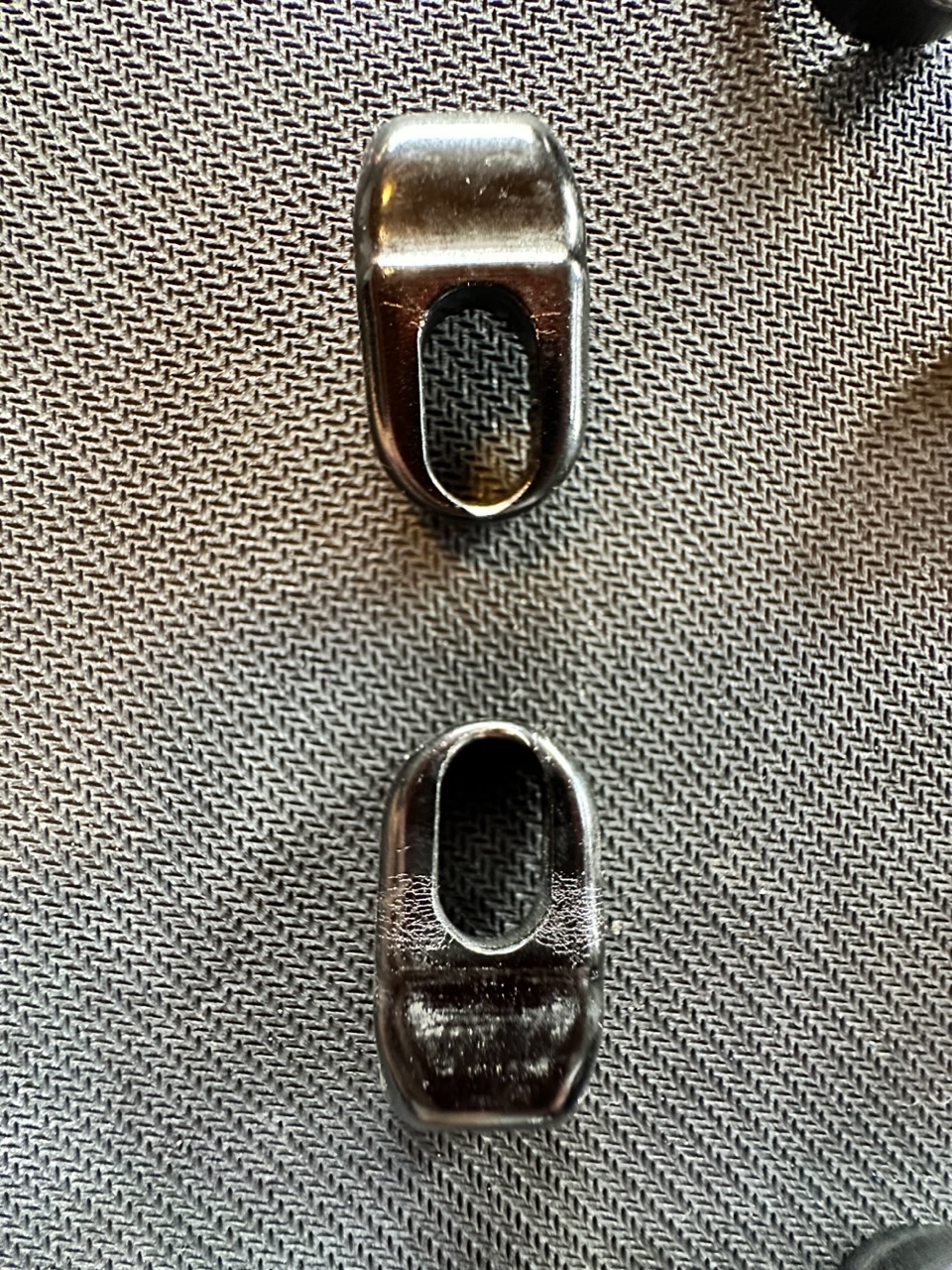

Has anyone else with a Felt AR had the upper clamp piece of their seat clamp crack? I was trying to find the source of a noise on my bike and when I put my hand on the saddle I noticed the left rail moving in the clamp. I double checked torque with a Shimano torque wrench and the problem was still there and I could see a visible light gap between the rail and top clamp so disassembled it and saw the following:

I knew it would happen! I had a felt IA advanced disc which uses the same clamping system. I had been used thick carbon rail and onday, I decided to test fit Sele’s ti rail saddle. The clamp was not firm at all even though I torqued it to 9Nm. I was wondering why, and today I found the answer. The culprit was the plastic deformation of those alloy thingies…

That’s exactly my situation as well. Regular saddle is a carbon railed S-works saddle and when I flipped the stem to install the CrMo/Ti ISM saddle is when I noticed the problem.

Did you ever find a resolution to this? Is it in fact due to the allow of the top ears bending from using the larger carbon rails? I’m having the same issue with my 2020 Felt IA disc. Was using a Specialized Sitero Pro with the thick carbon rails. Tried installing a saddle with normal size round rails, won’t tighten down…
Not sure I can point to the cause being the round vs. oval saddle rails but I was able to order the replacement parts through my local bike shop/felt dealer. Unfortunately, with the felt website redesign, they neither list those parts separately nor do the previous links I have to the parts go to anything.
If I remember correctly, the replacement “kit” came with all of the clamp parts, not just those two ears and was ~$100 total.

Interestingly, on the newer version, the silver part of the inner clamp is slightly rough/raw aluminum, on the original design, it was all powdercoated/painted and I’m wondering if that was some of the problem surrounding having to crank on that bolt to prevent slippage which results in those ears being bent.
One other thing to note is the “nut” to the crossbolt has a key on it that indexes into the small square inserts to keep it from spinning while you tighten that bolt.
