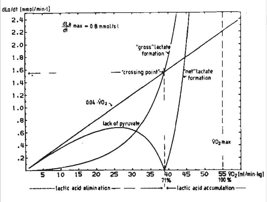

As an aside in 1986, Alois Mader indicated this in his model of exercise metabolism. This chart below shows that as lactate become more available fat oxidation goes down till it eventual reaches zero and lactate starts accumulating.
http://www.lactate.com/Graphic_files/Mader_Model_ANT_1986.jpg
Mader, A., & Heck, H. (1986). A theory of the metabolic origin of “anaerobic threshold”. International Journal of Sports Medicine, 7(Sup), S45-S65.
"There are people that are not burning 100% carbs at MLSS. In my testing I was only 70% carbs at MLSS although I am very “fat adapted” due to diet "
I don’t think this makes a whole ton of sense. Lactate would not begin to over-accumulate until you were burning 100% carbohydrates. In many ways you can’t be at MLSS until you you are burning 100% carbs.
You would just end up not being able to exercise at an intensity that would reach MLSS.
