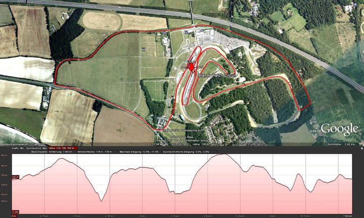

Now it comes to the question which is the best ZIPP wheelset to support my goal. The race course is a 7.5k lap with 120m hd per lap, for the TT 2 laps in clockwise direction will have to be done.
I expect a riding time of 25:00 min. which corresponds to an avg. speed of 36 kph.

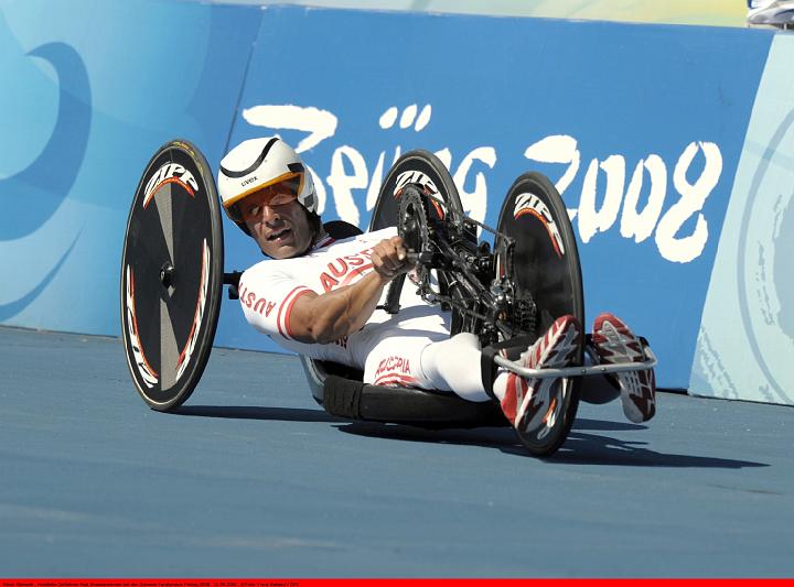

  • A handcycle has its drive wheel in the front and two free-standing wheels in the back, rear wheels are not covered by tubes
    http://www.handbike-power-endurance.de/docs/Peking2008.jpg
    Because of the low gravity center point and the front wheel alongside stabilized by the legs, crosswinds are not a big issue regarding steering, allowing a disk to be used as front wheel.

  • Average wind speed in September (when the TT takes place) is 17k/h, SW direction. The race course mainly takes course in WE and EW direction, therefore a fairly high yaw angle can be expected.
http://www.handbike-power-endurance.de/images/Rennstrecke.jpg
