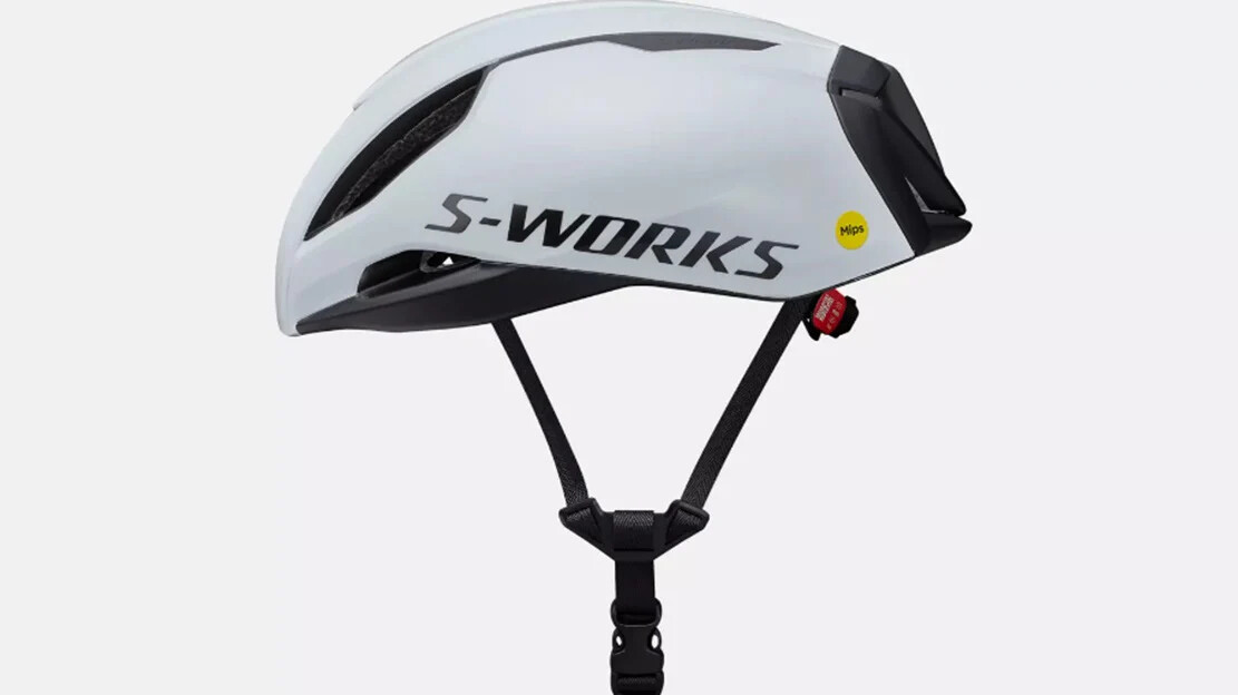

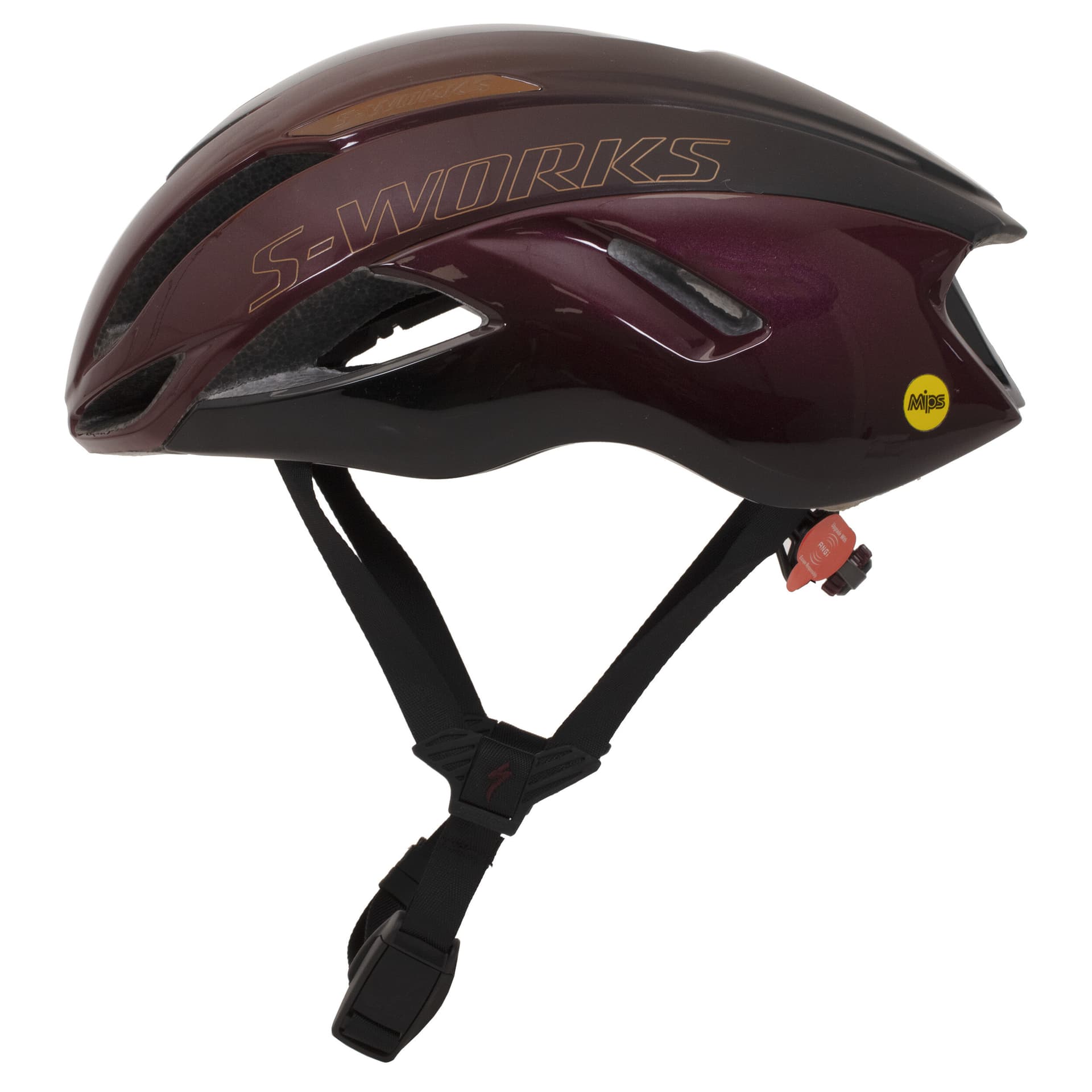

The 3 has a squared off back (so longer airfoil, Kamm’d to length).
Evade 2
Evade 3
