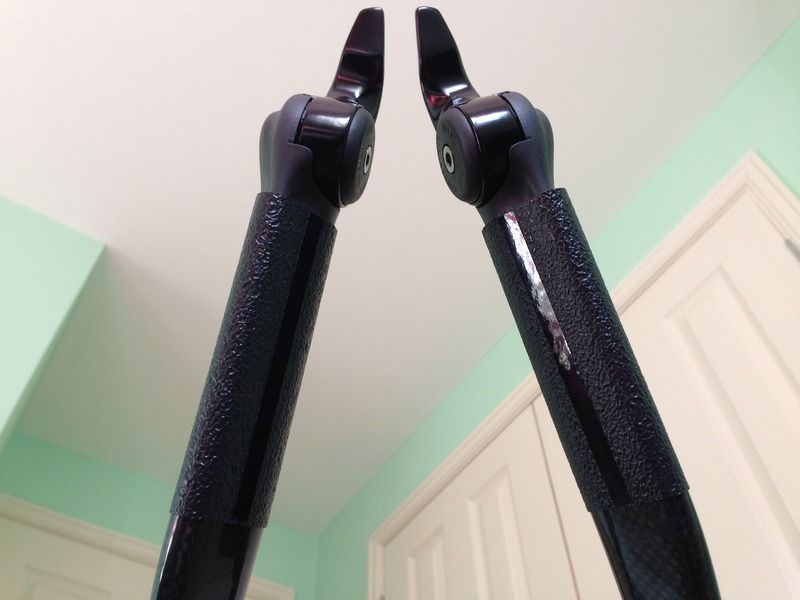

I don’t know your individual set ups but I have just switched from pool / spa non slip grip tape to adhesive backed neoprene.
Both might be worth a try for you ? Both are very cheap, easy to use and non destructive in removal.
I liked the pool tape, but now I have moved onto neoprene it is so much more tactile … :slight_smile: Jury is out on how long it will last but it’s cheap enough to replace frequently …
Pool tape would provide more support if you are needing it to add a bit of strength / structure.
Pool tape :
http://img.photobucket.com/albums/0903/Peter1/Exocet/58304054-A3CE-4C37-896E-A3D5C9870D6F_zps2gprcbyq.jpg

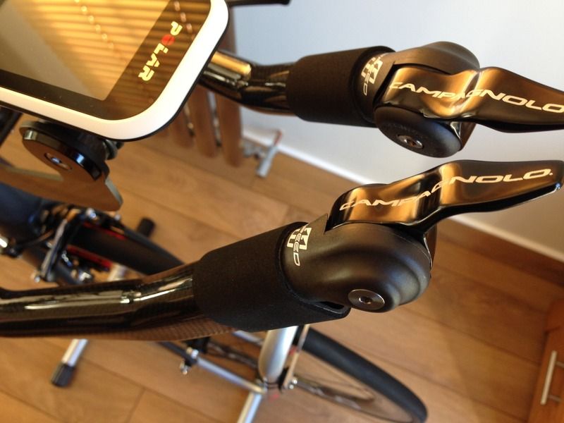

Neoprene:
http://img.photobucket.com/albums/0903/Peter1/Exocet/AE18B87F-CC62-4227-B8CA-A3AC63D407A1_zps2oqkgbwn.jpg

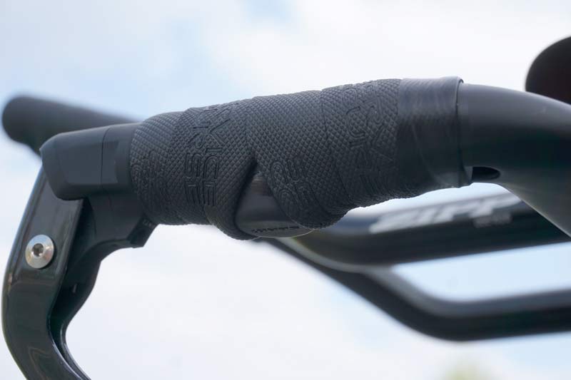

Sorry no pics but I am using blip grips on my zipp basebar. They were a little tight going on and you have to be careful with the wire, but it is a very clean solution and does not require any additional tape. Before the grips, I wrapped tape around the button, tucking in the edges, which worked fine too. Like this: https://www.bikerumor.com/wp-content/uploads/2015/08/SRAM-RED-eTAP-wireless-shifting-BlipBox-TT-shifter-buttons03.jpg
Do you have a link to where one can buy such neoprene sleeves? Looks good!
It’s 1.5mm flat sheet, mine came from eBay for £2.55 (250mm x 200mm) which is about enough to do my bike about three times over. Check out item number 261355714768 :slight_smile:

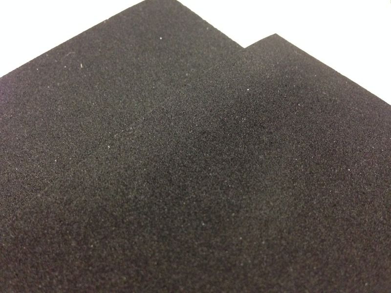

This is it close up :
http://img.photobucket.com/albums/0903/Peter1/Exocet/7124FA9C-949E-45CA-B909-DA5C35016CC2_zpstqatn2wq.jpg

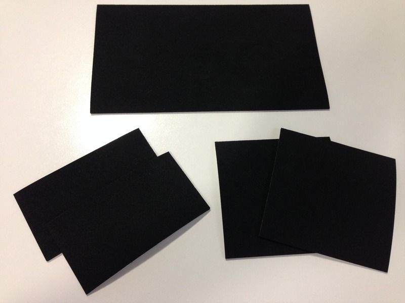

It cuts up real easy with a craft knife and steel rule, I used three of the four pieces that are cut in the pic - I hold around the shifters so I only needed half the origional length I cut for the aerobar grips :
http://img.photobucket.com/albums/0903/Peter1/Exocet/C11412F1-B55A-4B53-B3F5-B61A11CCF1EB_zpsqcv1rp8n.jpg

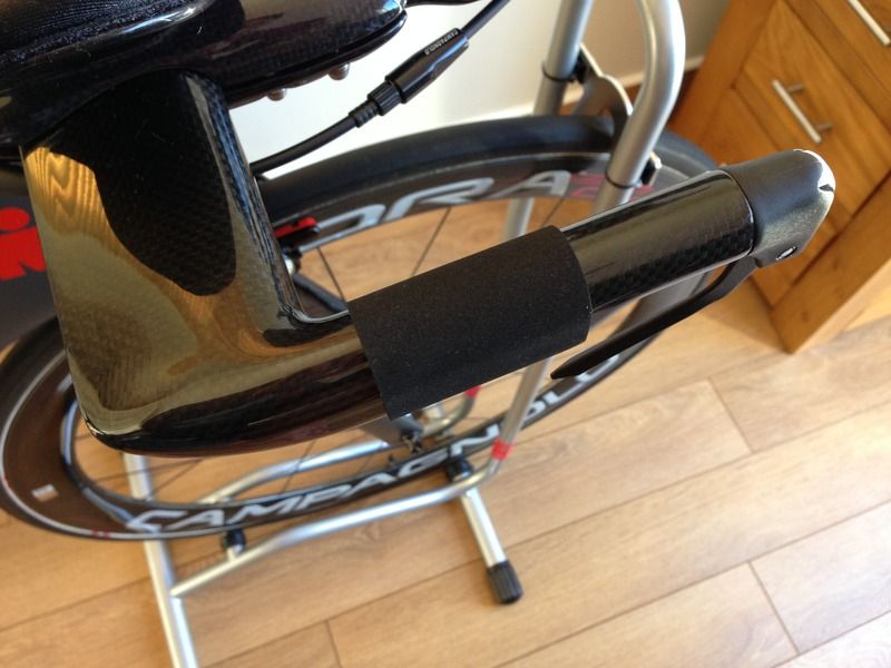

Once you know your size, just line it up nice and put the joint on the underside :
http://img.photobucket.com/albums/0903/Peter1/Exocet/65ADBAEA-2763-40CF-BD30-9C5A4EFA93D3_zpsw5cyatgw.jpg
I have done the bull horns too :
http://img.photobucket.com/albums/0903/Peter1/Exocet/E9F02ED8-01FC-42AA-B6BC-8F59AD9B7EDF_zpsdasyipdk.jpg
