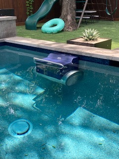

Hey, I actually just had a new pool built and had the Fastlane Pro built with it, so I could get a clean looking setup. Endless pools connected me with a local guy who had a deckmounted fastlane on his pool so I could try it first, and it was good enough for me to decide I wanted one.
My pool is 30x12-15ft, so it’s plenty big enough for a Fastlane. One think I hadn’t planned on is how much the kids love it and probably use it more than me. I have been using it 4-5x /week to supplement my swim training and now only swim 1x at the local ymca pool. I know it’s not a complete replacement for pool swimming but I can now swim at home anytime I want, so that option is key for me. It does take a little getting used to but the water flow is good enough to get what you need out of it. It does seem to be a strength workout as you technically aren’t moving through the water, but the first time I swam back at my YMCA pool I was really surprised at how much better I felt in the water. It does force you to focus on your technique/form (in the fastlane), and that will directly translate to the pool from what I can tell so far.
Bottom line is I’m so glad I decided to pursue one during our new pool build.
