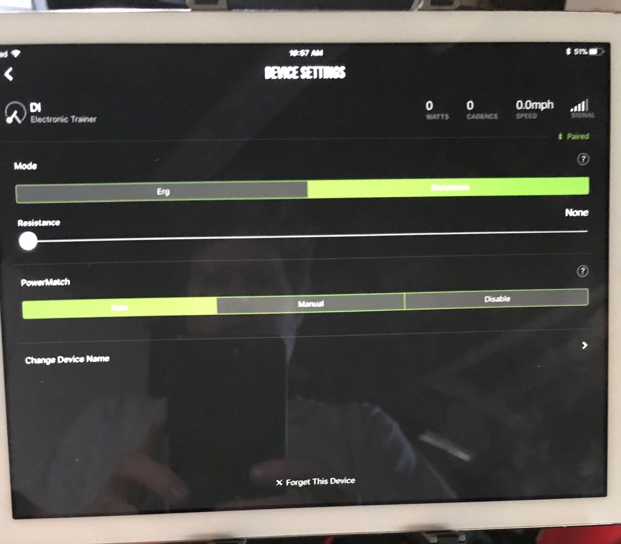

I use an iPad with mine - do you get to a screen like this?
Sorry, just actually read your title - Erg mode problems. I’ve been using resistance only w/ no issues. that obviously doesn’t help…

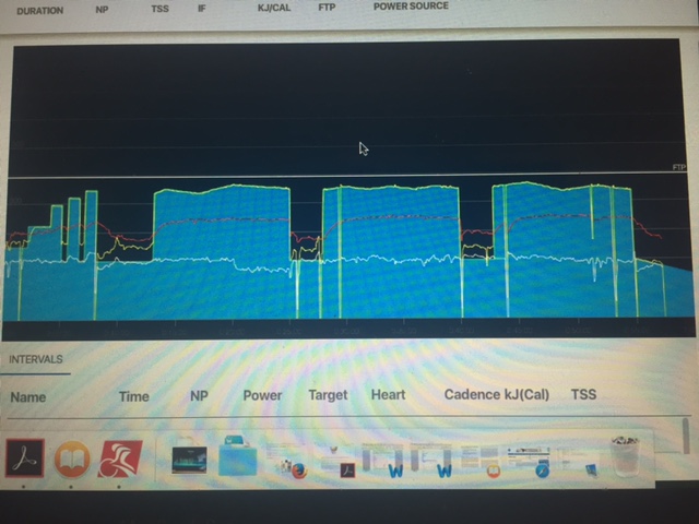

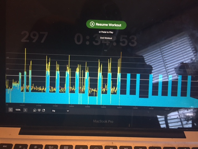

Well the unplug was able to turn the erg mode on. Thank you to everyone for the replies. Unfortunately this brought up another problem during the actual set. The control of the power is all over the place. This is manageable on the recovery portions, even though it is consistently over the prescribed power, but the constant spikes during the set seems to void the point of the of the workout. I do have a QX1 ring, which i though may be causing some issues, so I traded it for a round ring for the second set. It didn’t seem to do any better with a round ring. Any more ideas? I had a kickr snap that did the same thing before doing an advanced spin down, but that stabilized the power, even with the QX1 ring. I attached a picture from the Kickr Snap trainer. It did a fantastic job when I could get it connected, and it stayed connected.
re: your second problem, I am finding the direto a little bit picky about gear choice in ERG mode, depending on the prescribed power intervals. If you want to get around 100-400 Watts at cadences between 80 and 100, I find that small chainring and middle (15-17) cog works better.
I second this (using smaller chain and middle gear). I use a 10spd on the device.
I’ve found this as well. The Direto struggles with low resistance (e.g. 100-150 watts). My first few times using it I was in 52x15 or thereabouts at ~80rpms and the lowest power the Direto was able to obtain was ~150 watts even though TR was calling for ~100 watts.
