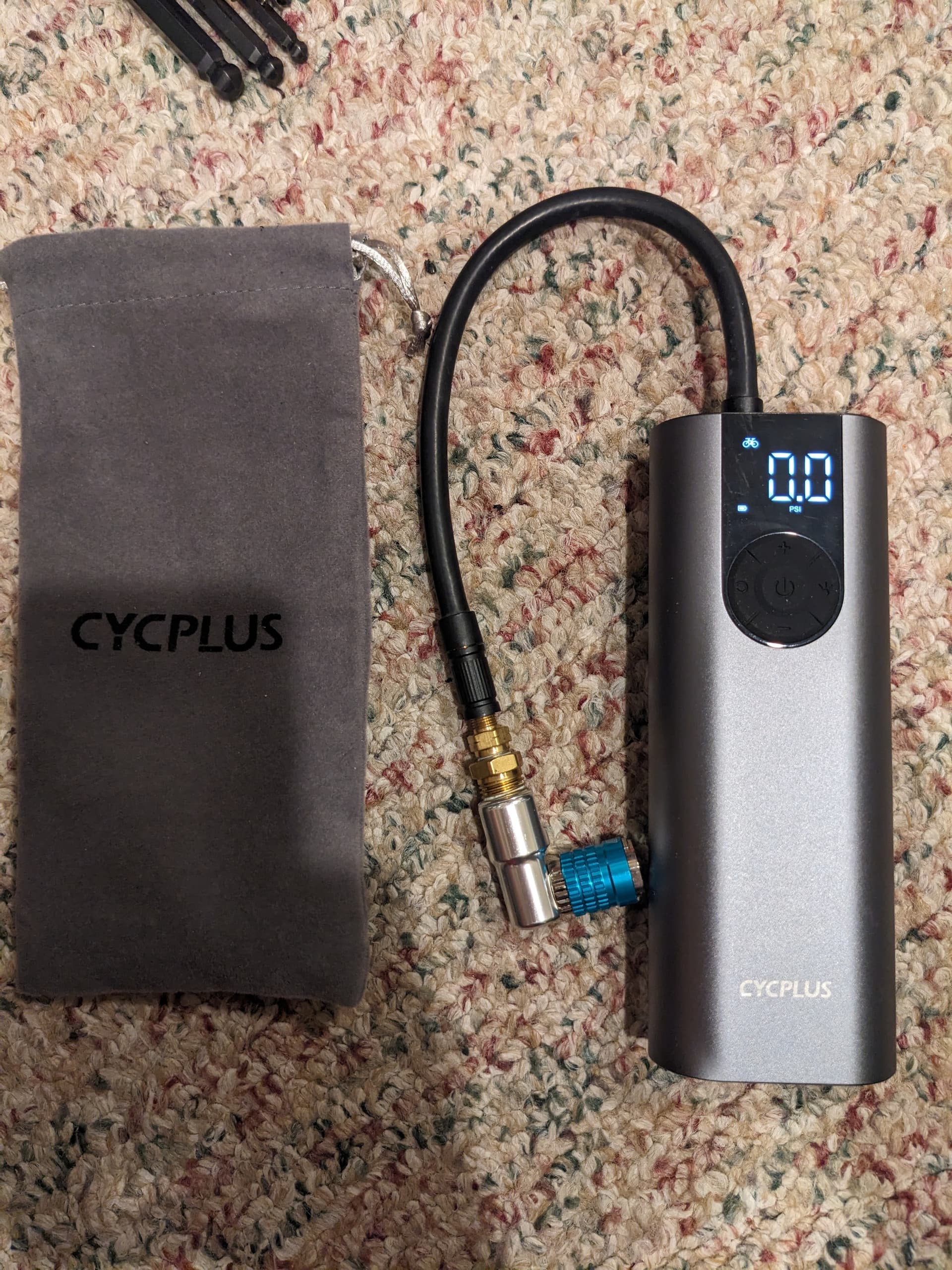

After double-checking, this is the pump I got, the AS2 Pro. Amazon switched the links in my history.
CYCPLUS AS2 PRO
Yes that’s the type I had in mind! WAY better with the PSI display. Without it, you end up only use it as a last-ditch effort after a flat to stay moving. With it, its a super useful piece of kit that you should def have in your triathlon bag, especially for the AM bag for 70.3 or above, as the pump lines DO get super long (at least at all the races I’ve been to they’ve been super long!)
Thanks for the clarification. The first original link you posted shows a much smaller unit than the one you currently have. Does yours fit into disc wheel cutouts without using an air hose?
I got a crack pipe I used to inflate my disc wheel.
No psi display is also a deal breaker which is why I went with Cycplus over Fumpa. My Hed wheels have a max inflation limit so I need to know the number. With a Fumpa it’s a complete guessing game or I would need to carry a gauge as well. Not happening when other companies have a built in display.
I also have the AS2. The only downside I see is that, even with the hose that comes with the pump, I cannot connect it to my rear disc. It would be nice if there would be a 90 degree hose like Fumpa has. Does anyone know if the Fumpa hose would fit the AS2?
