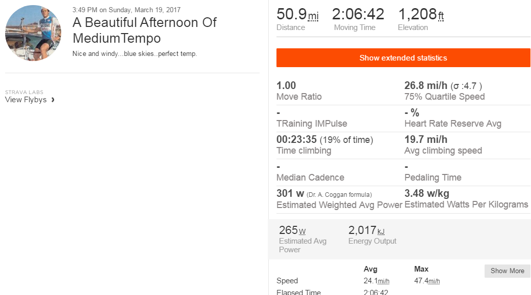

I used these “very raw”…actually cycling shoes that Iiked…just stripped down…but very much unfinished as I only started this morning and rode in them this afternoon to do this on Strava. I’ll provide as many details on this project next.

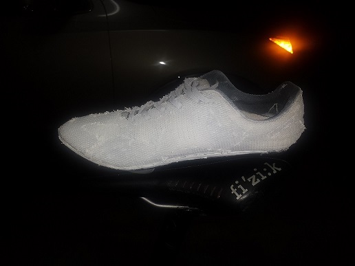

If you are not using a new carbon sole…you can easily remove one that you like.
Razor the edges against the sole and the upper will rip right off.
Try not to remove the cleat bolt threads…but if you screw it up…it’s easily resolved…I’ll go over that later.
Clean it up…get all the crap off that you can…that stuff is useless …excess weight.
