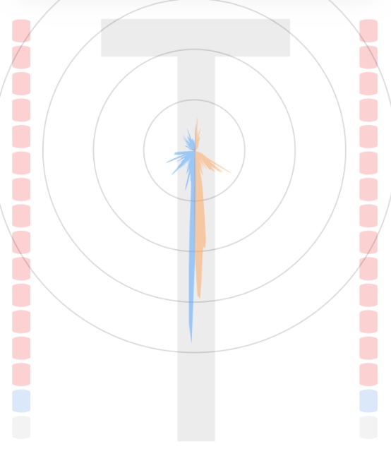

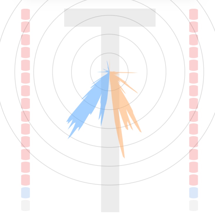

You’re kind of right and kind of wrong. You can see it, particularly in the visualization of the force, where it shows where you are directing force.
Below are two different swimmers. The first one is about 1:35/100 yards and you can see a lot of force is directed off to the sides. The second is a sub 1:10/100 swimmer and it’s more directed straight back in a thin line. That has everything to do with how the athletes are moving in the water. The first athlete is creating a lot of drag because they aren’t holding a straight line. The second one is.
I hope this helps.
Tim
