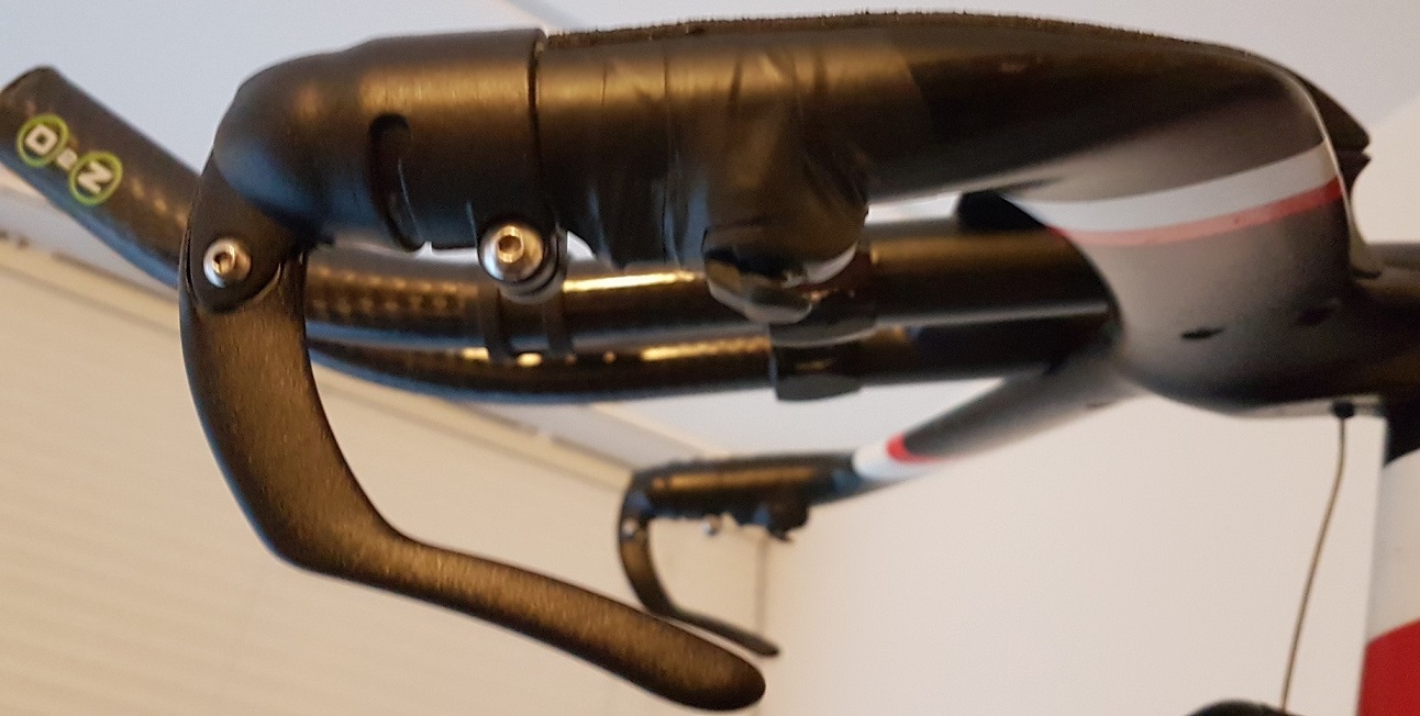

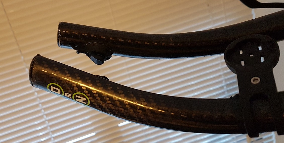

I use them both as shifters at the brake levers and as shifters on the end of my extensions. Works fine plugging them directly into the junction box.
As an aside, I believe Shimano is now making a small 2-port junction you can use to extend the wire - you might have trouble getting the wire on them to reach the junction box.
Thanks, this is my plan as well. I have a couple of b junction I can use to extend as well, but if they are making a connector now that would be better.
Would it possible for you to post a pic of your setup if you don’t mind! I’d love to check it out
Snapped a few quick pictures.
