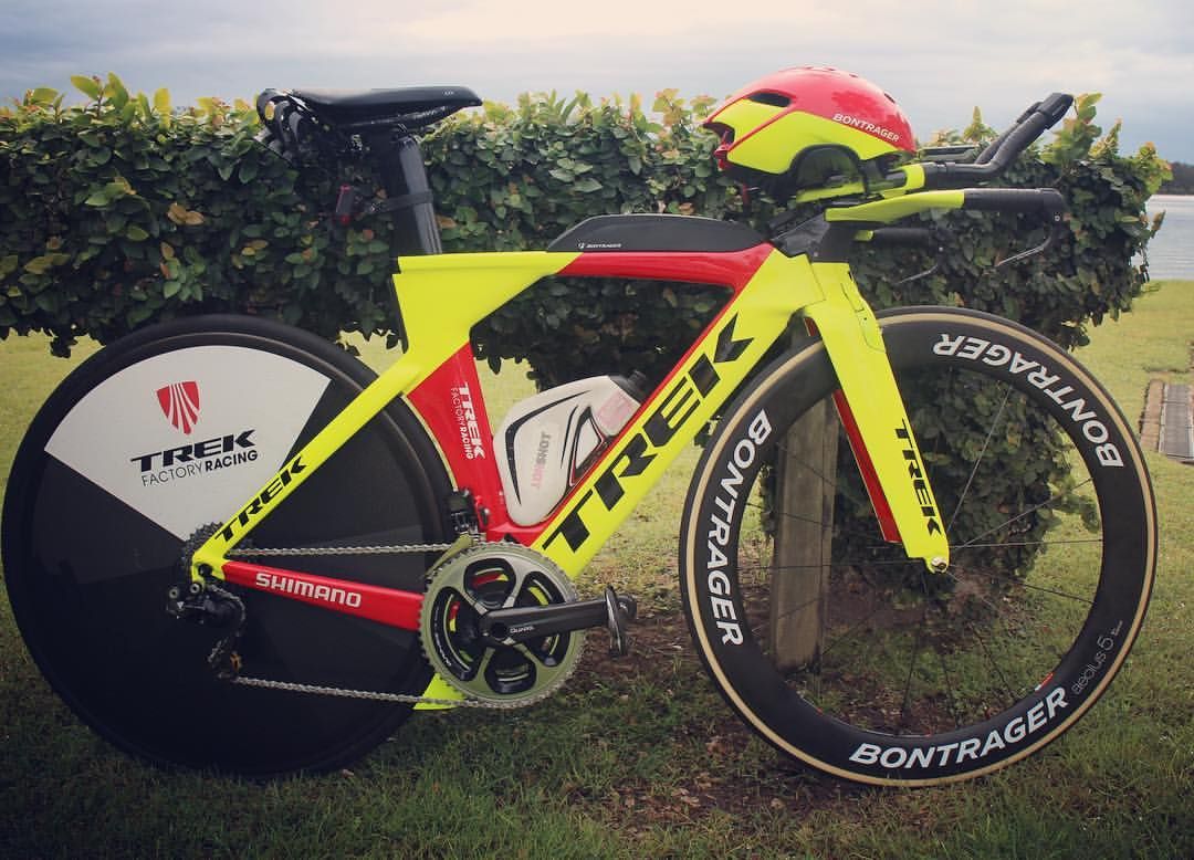

I’m riding a Trek Speed Concept 9.9 2016. And I was wondering if i could save some time (getting it more aero) by putting a specialized Virtue bottle on it, so it would fill out some of the gap in the triangle of the frame.
Basically like on this picture:
Or would it just give more drag?

I have seen Tim Reed have it like in this pic. So my questin is: does it give more drag, less drag or drag neutral?
(i also got a Speed Concept like this)
I Tested that bottle on a Shiv TT and seen it tested on a Transition. Basically aero neutral at the yaw angles I tested. If I had to guess, I would say it is likely to make no real difference on an SC. The Kahm tail down tube mimics a 9:1 airfoil, which theoretically “fills” that space.

I’ll have to look back at some of my old A2 data, but I tested that bottle on my old bike (Planet X stealth)
As I remember it wasn’t “neutral” exactly… a little worse at 0 and a bit better at yaw. I’ll have to see exactly what the #'s were though.
