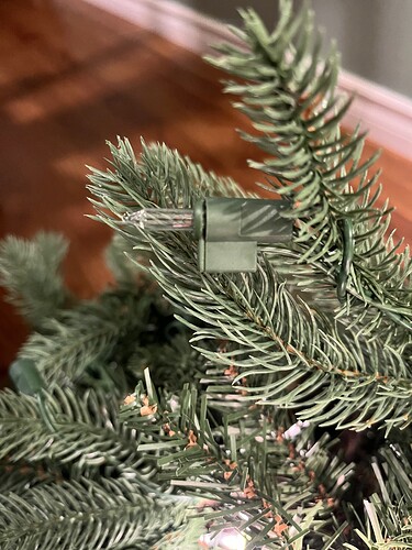

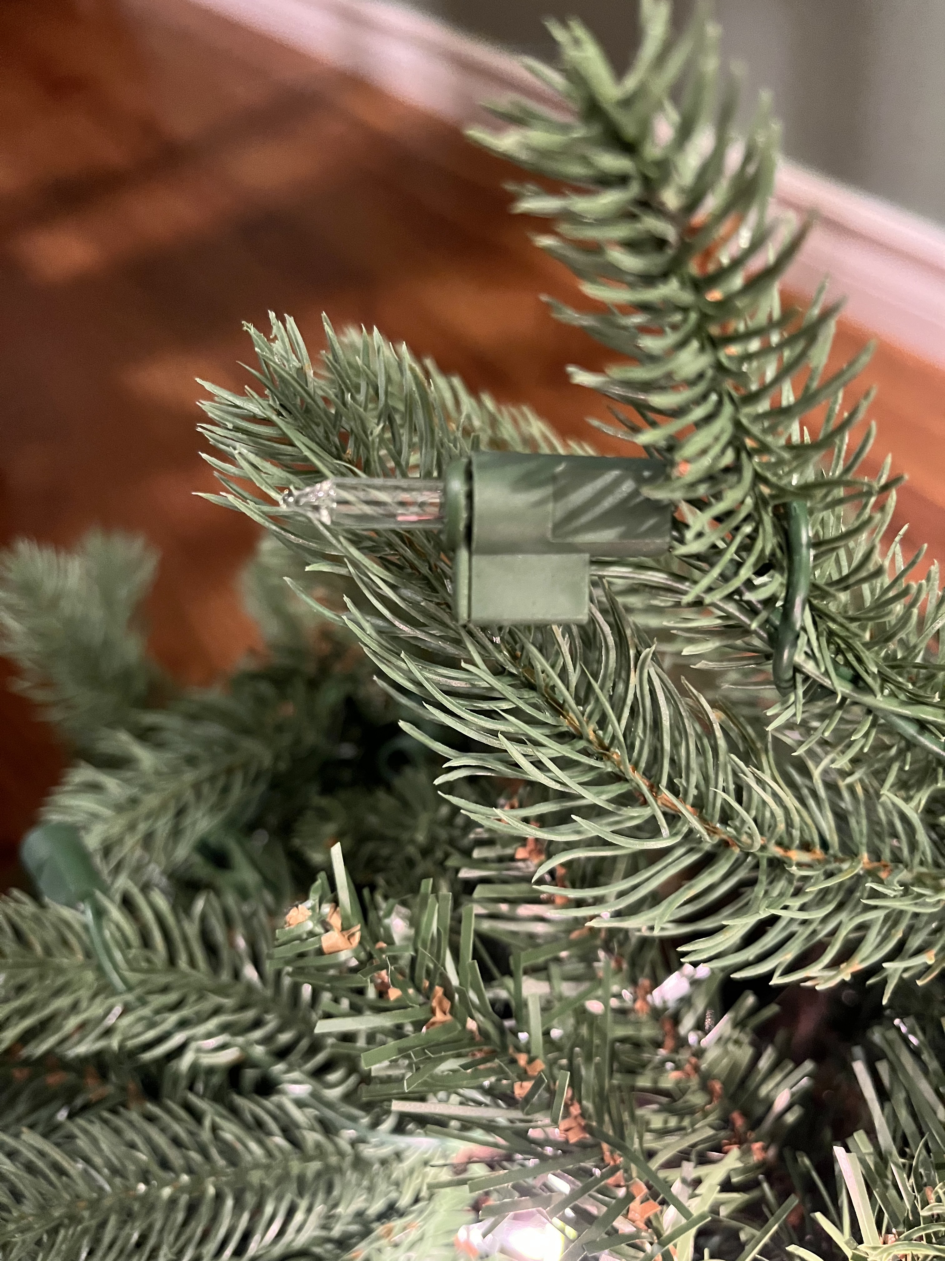

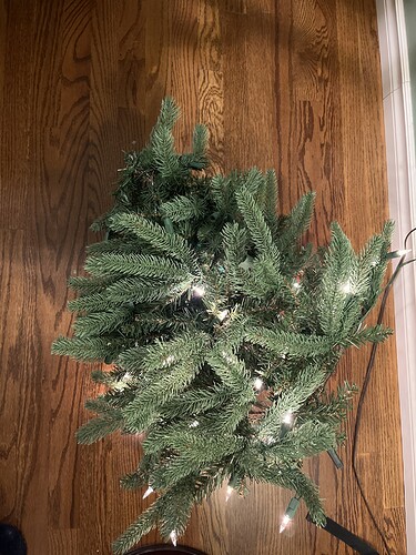

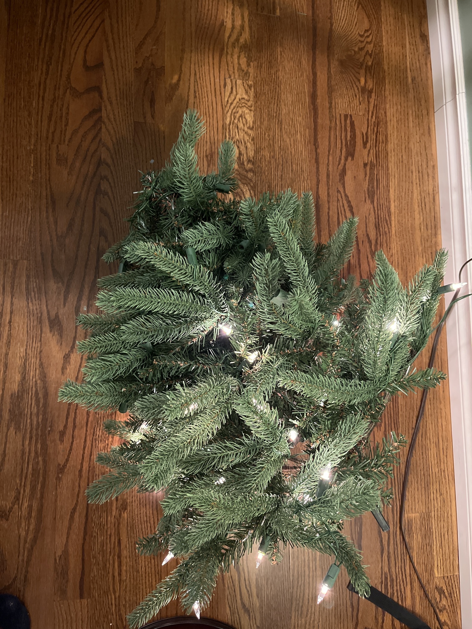

Ok here’s the top of my tree. It has built in lights. About half the top works. The other half doesn’t.
Most of the lights look like this one.

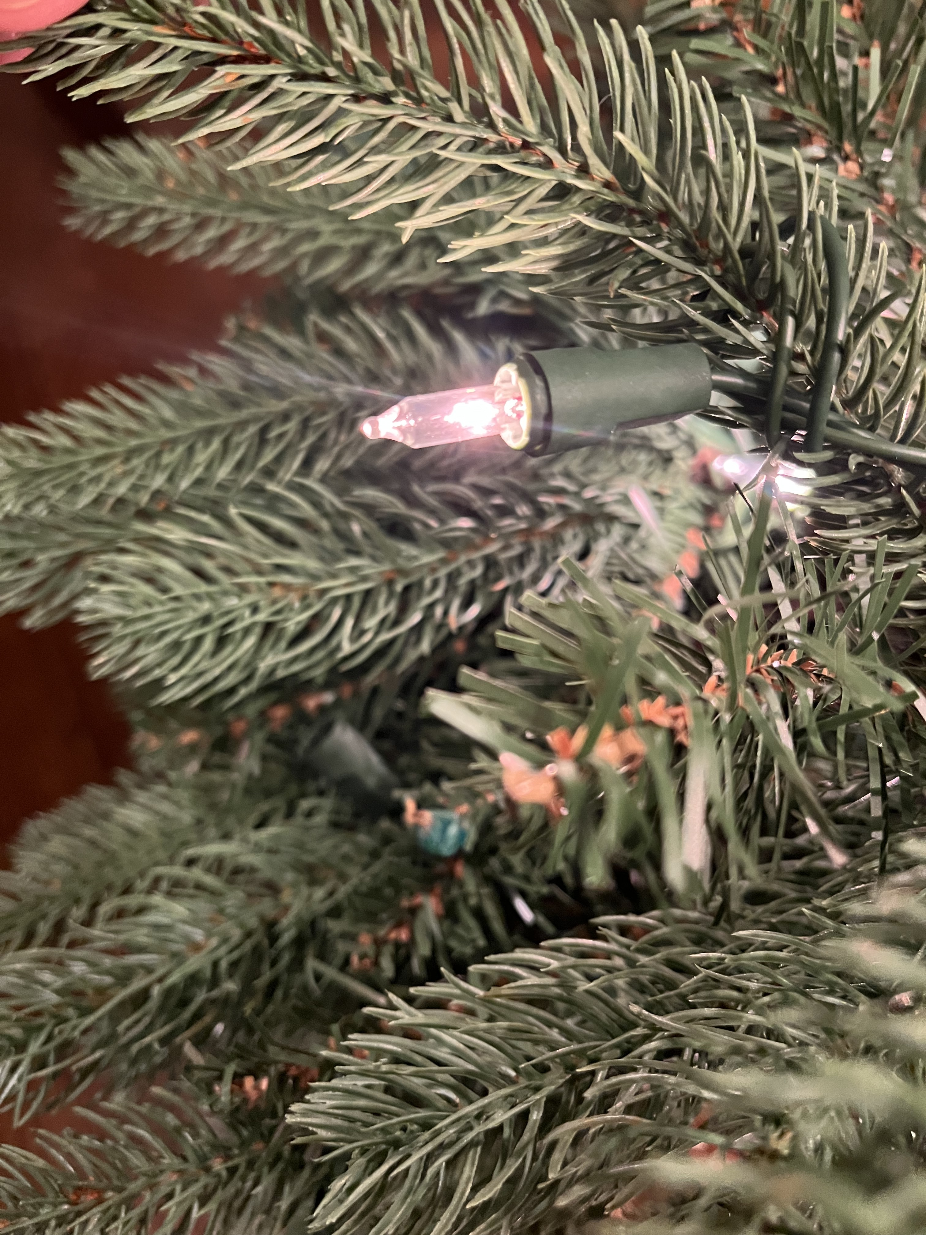

But some look like this.
One of the bigger ones (second type) when I removed it the whole strand went out. So I figured the others that were like that also controlled a bunch of lights. But they don’t seem to.
