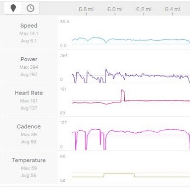

At least with my experience with afib, while using a Bryton HR strap and various Garmins (500/920XT/530), they seem to work. I actually first noticed my afib with occasional spikes showing up on Strava, which progressively got worse and worse. The sudden jumps in HR corresponded with a feeling like I got the wind knocked out of me. That feeling would go away at the same time my HR dropped back to where it had been before.
But even when my HR would stay up in the 180-220bpm range, it never affected my max HR or zone settings. Post ablation, I still occasionally get a quick spike, and those show up on my Garmins and on Strava:
