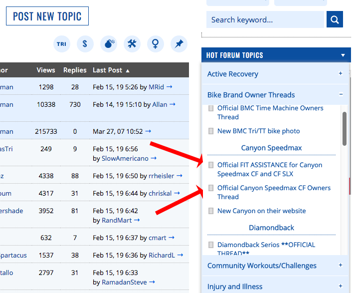

turn down HOT FORUM TOPICS. turn down Bike Brand Owner Threads. there are 2 threads there that could help. 1 is specifically designed to help with fit issues. post there.
Thanks for the tip Dan, but I have checked the thread but there every question is about the Speedmax, I’m talking here about their roadbike, the Endurace CF SL 8.0 Disc.
