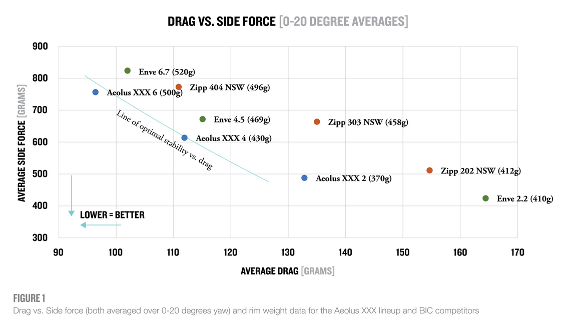

I found this chart from the white paper particularly interesting:
http://i66.tinypic.com/15mgzs4.png
I’d love for someone to do a white paper and show they are second best, it’d be more believable.
Trek kind of did with the Speed Concept 2. (More drag that P5 at low yaw).

Wonder why they didn’t test against 454?
