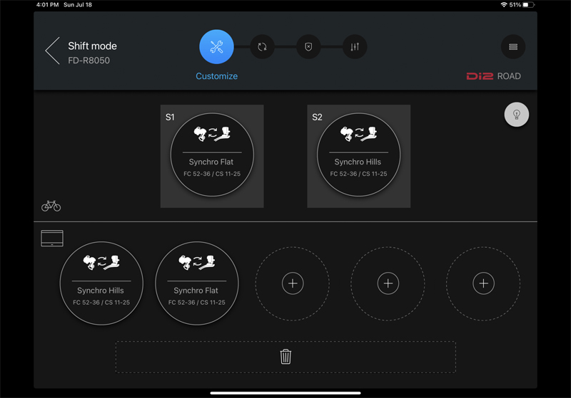

Here’s a quick screen shot that may help. From the main “Customize” screen, click the “Shift Mode” circle and then follow the questions through until you get to the screen that has a visualization where you tweak the synchro up & down shift settings.
