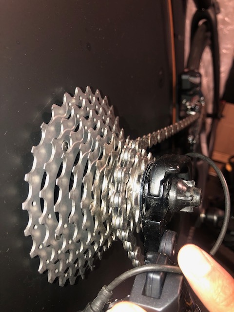

I actually broke my original one and replaced with a brand new one. It is a Ventum One bike rim brake. So the hanger is custom made from them. I don’t think there is many ways to insert it. See pictures attached.

What preceded this issue? Was it replacing the derailleur hanger? Any other work? I ask because your photos show the upper derailleur cage wheel pushed out a long ways from the cassette cogs. Turning the derailleur b-screw way in could cause this position. The lack of chain wrap on the cassette could cause so,e shifting and engagement issues.
I smashed my previous derailleur hanger and after I replaced it the problem started. I had it looked at and the derailleur should be in good position.but yeah it might be what you are suggesting. No idea to be honest. Thanks for the reply !
