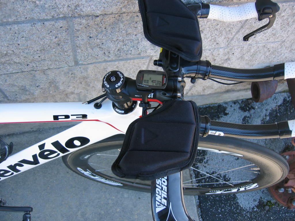

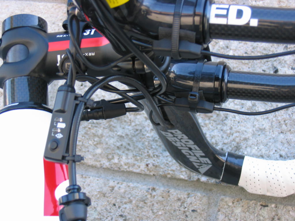

You mean like these pictures? I’ve built up a few bikes with DI2 for customers and can answer specific questions that you might have. There are more pictures in the photo gallery on our website of bikes with DI2. Two of them are internally routed with the R3 done externally.
http://www.frontofthepack.com/portal/images/2010/p3/IMG_7708.jpg http://www.frontofthepack.com/portal/images/2010/p3/IMG_7709.jpg
http://www.frontofthepack.com/portal/images/2010/p3/IMG_7712.jpg
damn shit! I thought one of the key benefits was “less cables”
Well you have cables for the shifters, brakes and then the extra set of cables for the shifters on the brake levers. It looks much cleaner when we’ve put them inside the basebar but this customer didn’t want me to do any extra work (drilling) to the basebar. Some basebars are easier to work with than others.
How does the cable run from battery to the controllers?
The cable to the battery runs inside the downtube, exiting just behind the head tube. That one is internal along with the cable to the front derailleur. The rear der. cable is external.

Which set of cables are you using? The internal or external kit? The difference will be the size of the connectors.
If you’re using the external kit I wouldn’t recommend running it internally at all as you will need to make pretty large holes in order to get them through the frame. The internal wiring kit has cables that are a little longer and will connect to a junction piece.
You’re correct with the drilling other than that. Drill behind the head tube and expand the area around the BB for the front der. For the rear der. I would run it externally as the hole at the drive side dropout is closest to the cassette and thus not conducive to running the wiring internally.
