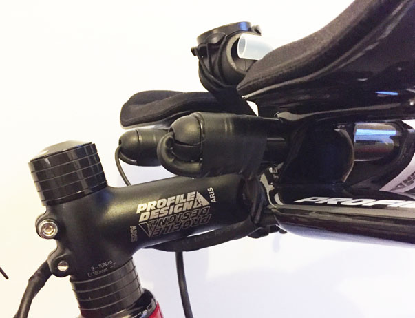

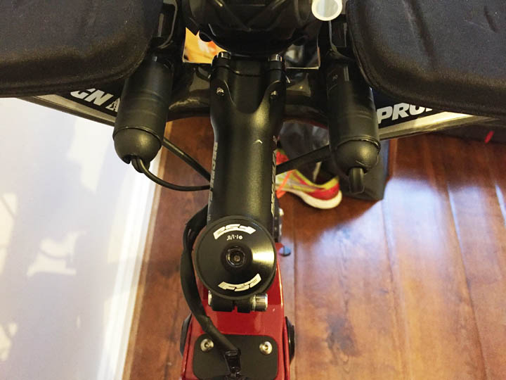

Anyone is interested this is how I ended up running my install. I’m sure not the cleanest thing but my first foray into this type of modification. I think i’m getting the most out of the Aeria T4 bars with this sort of setup, I could probably clean up a bit more by rethinking some cable lengths and then really taping/binding the wires down in some other fashion.
Hid JC-41’s in the extension bars and then ran one wire back to the 5 port box stashed in the bike (totally inaccessible during a race).
Given I added a BTA setup at the same time it does seem all little funny but I think i’m going to like not having the di2 box below the stem exposed as well as keep it from getting totally gunked up from liquids/food. Give it a few races, maybe I’ll rethink and try something else after I’ve had a bit of experience with this installation.
I didn’t realize you were setting up a Dimond. Stashing the Junction A in the beam isn’t too bad. My wife’s is set up that way because we still haven’t finalized her bar set up.
