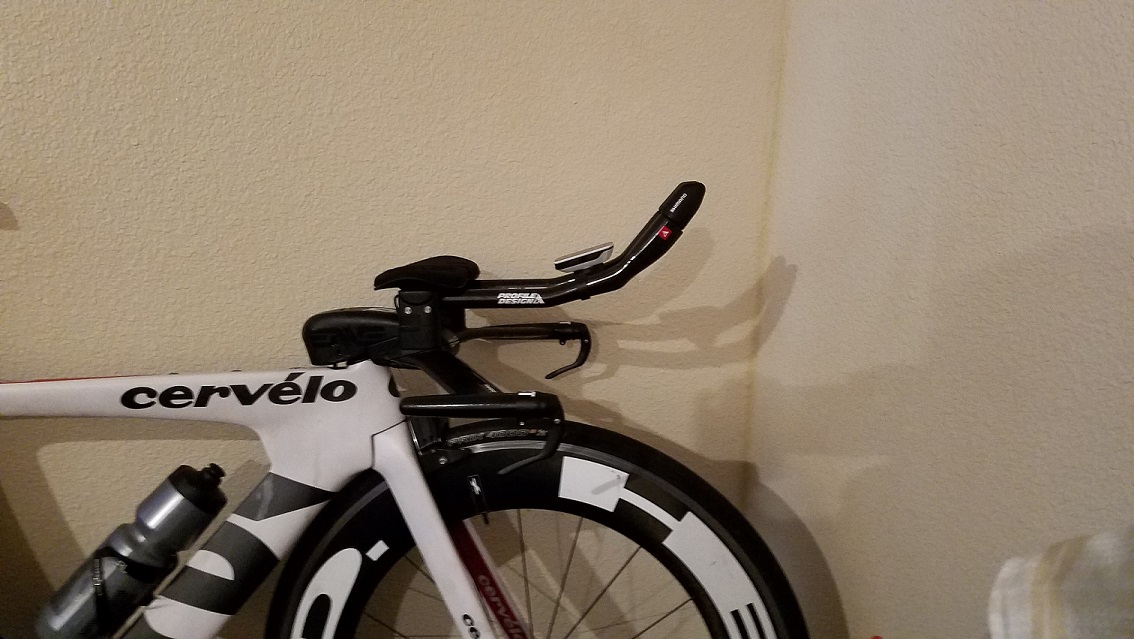

My 2018 P3 is having a remodel as we speak with a TriRig Alpha One and TriRig Front Brake…and yes, I have DI2, so they (my LBS) are hiding everything.
I couldn’t pull the trigger initially, when I was having the frame built up and I only went with DI2 not a complete change of the cockpit, but it’s clear that I need more adjustability and I also wanted to get rid of the cables/wires. Will let you know how it goes.

oooooo
so pretty…now, I can’t wait!!..
http://i67.tinypic.com/2wdc004.jpg
http://i63.tinypic.com/2eo9vnn.jpg
I just upgraded to di2 last week. I used the Alpha X bars. Hardly any wires showing. The only thing coming from the stem to the frame is the brake cable and a single di2 cable which I put in shrink wrap to clean up the look. I would definitely suggest trying it yourself if you are at all interested. Was not difficult at all. Plenty of room for all di2 wires and junction in the stem. Plenty of room in the IA for the junction B and should be for the P2 as well. Not sure how easy the P2 routing would be compared, but the room would be there. It was very easy to route in the IA16.
