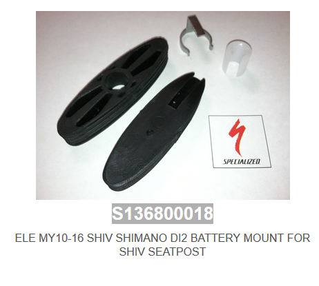

For internal battery, you need to order this part with your LBS :

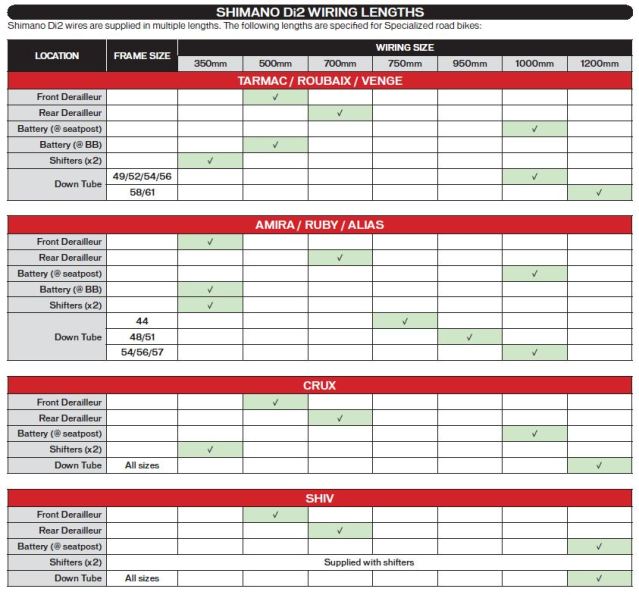

For di2 wire length, here is the schema sent from specialized :

  • Shimano SD50 Di2 Electric Wire (see schema for length)
