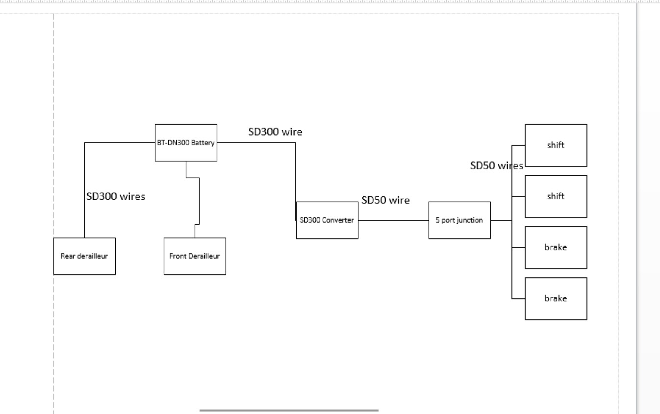

Does the attached amazing visio diagram look correct?

That is close except I don’t think you can use a Junction A as this function is now controlled by the RD. You’ll need multiple Junction B’s or e-tube Y-splitter wires to join the shifters together. Also, the 2 button R671 shifters will not work with the 12 speed di2 configuration. U will need the one button aero extension shifters R9150 or the satellite shifters R9160.
See the 12 speed e-tube compatibility chart in the Dual Control Lever with SD-50 box here: https://bike.shimano.com/content/dam/e-tube/assets/images/contents/project/compatibillity/pdf/en/HM-CC%205.2.0-00-EN.pdf
See the 12 speed e-tube compatibility chart in the Dual Control Lever with SD-50 box here: https://bike.shimano.com/...CC%205.2.0-00-EN.pdf

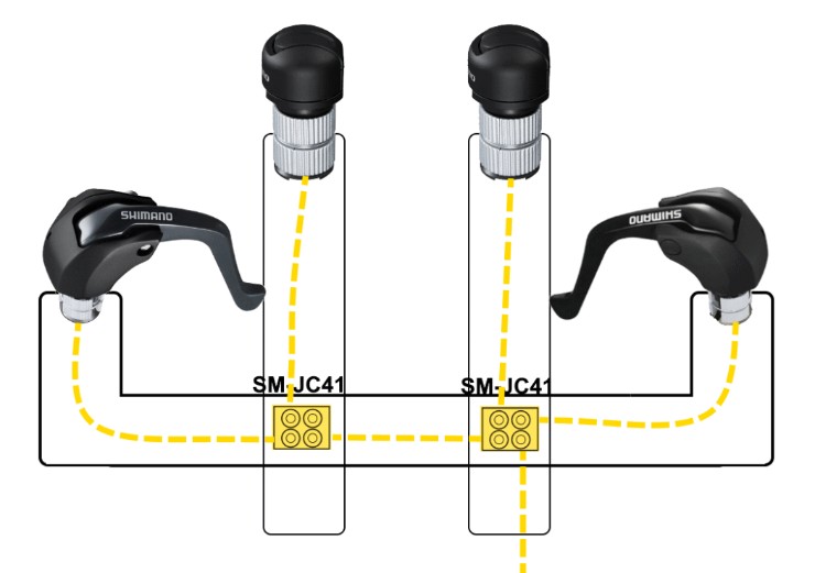

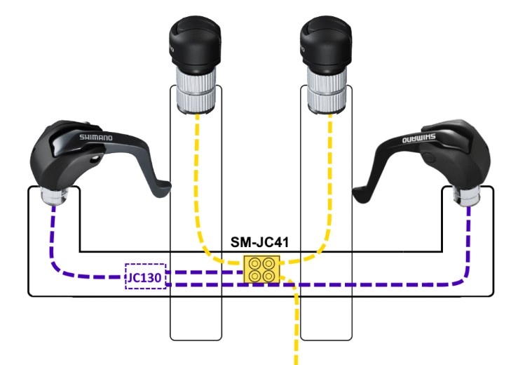

Yep! Correct. You cannot use SM-EW90-B or any other 11-speed Junction A.
You can use either of these methods setups:

Yeah… The TT shifters that’ll work are:
ST-R9160 Rim brake lever and buttonST-R9180 Hydraulic Disc brake lever and buttonST-R8060 Rim brake lever and buttonSW-R9160 bar-end switches
And SW-R9150 (satellite shifter)
