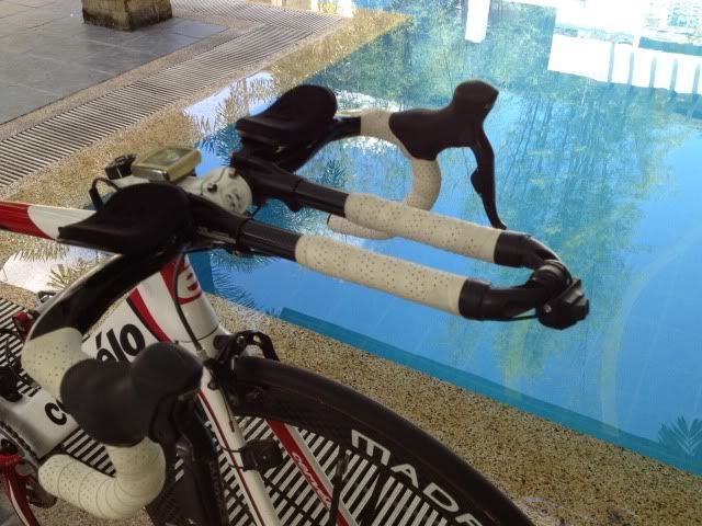

I did what you have (road shifter with climb button) but placed the climb button on the end of my aerobar.
I had to cut the wiring so it will reach the road shifter plug receptor on the side of the hoods.
http://img.photobucket.com/albums/v236/campled/Cervelos/IMG_0606.jpg
If your daring enough to lose the warranty…you can splice & insulate on your own. Not a very hard task.
You will have to splice it here:http://img.photobucket.com/albums/v236/campled/Cervelos/Di2splice.jpg
