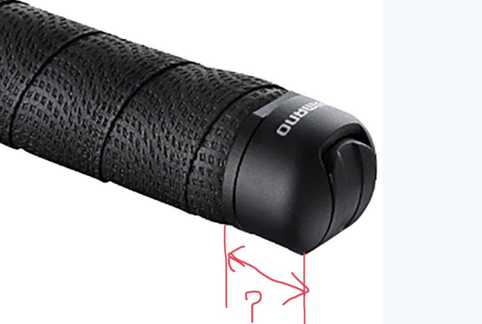

Can I ask the OP, or anybody else running with Shimano 9160 aerobar switches a quick favour.
I am looking to upgrade the switches on my aerobars from the older version where the switch itself is located on top of the aerobars, to the 9160’s because they have the switch on the end of the unit which suits my hand position much better.
With this slightly modified cockpit setup I need to stay within UCI TT rules so will need to lengthen my aerobars to compensate for the shorter length of these switches - so before ordering, I need to know how far the 9160 switches physically protrude after installing from the end of the aerobar (see photo for clearer explanation). Looks like approx 20mm from the pictures, but I can’t find the exact info anywhere, Shimano only give a weight, but no dimensions of any sort which is not very helpful.
Would you be able to take a ruler to yours and measure for me? Thanks in advance it would be a great help.
I got a chance to measure it. By my eye, the shifter comes out about 15 mm from the wrap. It’s pretty small!
All I need, thanks for this.
