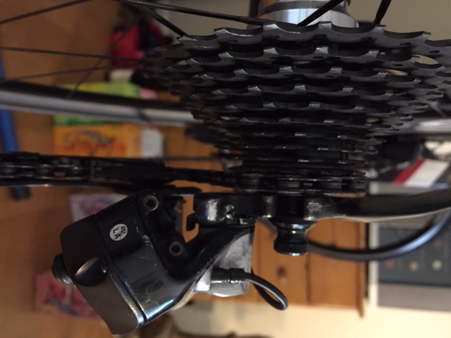

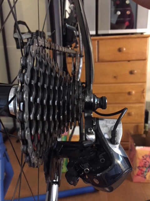

Here are where the limit screws are … I am not able to rotate the image … (also excuse that the chain needs some lube).
No way for us to tell from the pictures. You really have to zoom in on the limit screws. I always need a flash light in order to see the gap.
