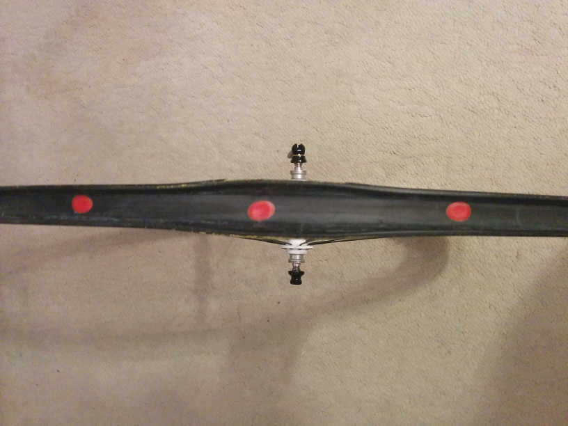

I have had 4 pair of wheels from them with various depths and widths. I have found them to be great. I do think that the comments about braking and heat resistance might be somewhat correct. I burned up one set of clinchers on a really steep mountain decent. I however have done 100’s of descents without any problem with their rims. The braking performance is not good compared to my road bike with aluminum rims, but I also blame the TRP brakes as not being as good as my road bike brakes. I however just got a new road bike with disc brakes and carbon clinchers from Dengfu and they have been great. Except that they are a bit on the heavy side, because the increased spoke count and discs. Anyway my $.02.
Regarding the breaking- what do you mean by “burned up”? Also, were you using their supplied pads or something else? I have heard the black prince pads toed in slightly are where it’s at with basalt braking surfaces.
What I mean when I said I burned them up. I mean they got hot enough that the wheel started to deform. Here is a picture of the damage. I was using Yellow pads at the time (can’t think of the brand right now) and I had placed the wheels on my road bike. Normally they are on my TT bike. Never had a problem on my TT bike using the pads they supplied.
I included a picture, but for some reason when I am looking at this post it doesn’t seem to be coming up.
