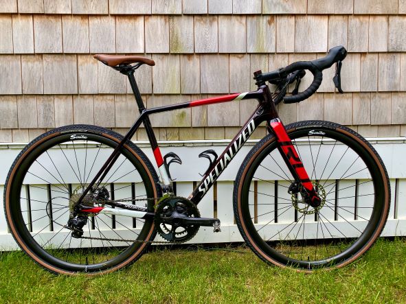

I’ve had a set of Scribe Gravel Wide’s on my Crux for about a year and a half now. Zero issues whatsoever, they’ve been bulletproof and the ratchet hub works flawlessly. They’re definitely louder than any other hubs I’ve heard but the engagement is quick and you get used to the sound.
