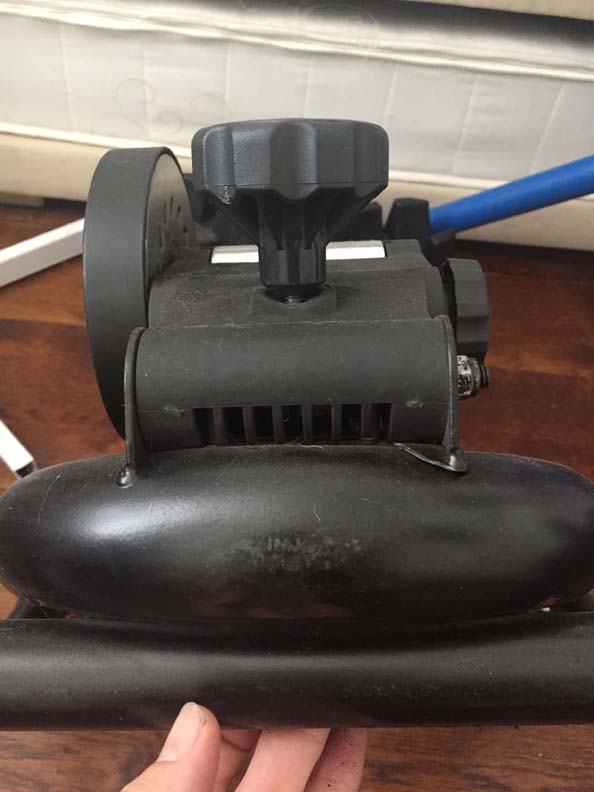

So after roughly 3 years of use the weld on my CycleOps trainer failed. I’ve since replaced with a Neo but still have the old mag trainer kicking around (not totally sure why). I emailed their customer support to see if they could help me out with a replacement (figure would be a nice back-up or my wife might use it for some indoor cycling). Anyone have a similar issue with a successful resolution? The kicker is that I bought the trainer when I lived in Boston, now in London so not sure how the ‘return/exchange’ type thing would work…

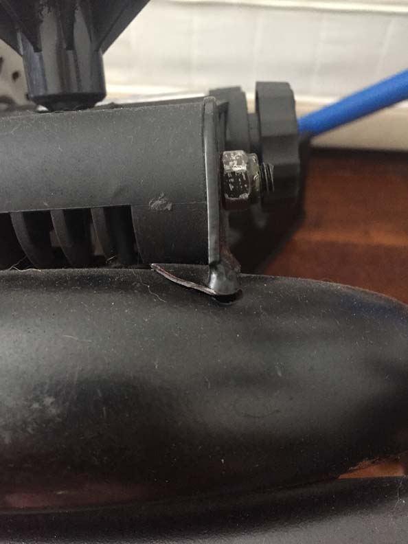

That is not a weld failure. The weld is in good condition. The base metal itself fractured.

The fact the weld us intact should not make a difference. Some part of the frame failed. As long as you were not taking a hammer to it they should honor their warranty.

Yep- not technically a weld failure - it’s in the base metal / HAZ. Try a warranty claim. But if you get nowhere it should be easy enough for a competent fabricator to repair.
I’d bring it to a cheapo exhaust repair shop for a quote. They weld all day and it’s an easy job for them.
