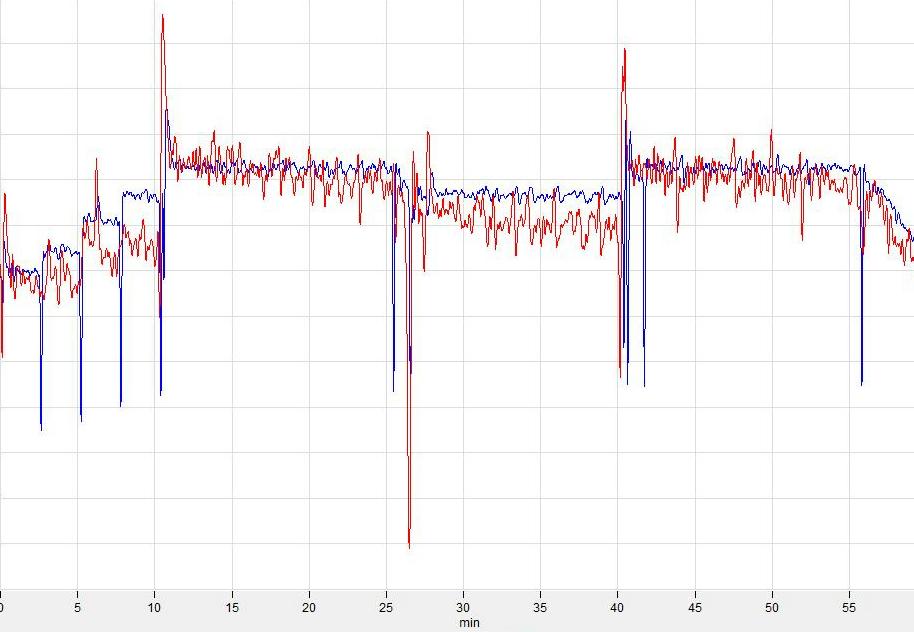

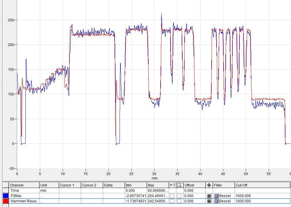

I think i’ve got to the bottom of the problem.
It appears that it’s something in trainerroad. it’s only doing it when i run it through TR, and does it either in BT or Ant+ mode.
Using Rouvy, it tracks where i’d expect, so looks like I’ll have to email TR support, or at least temporarily use power match.
Attached pic has had a few little tweaks as rouvy autopaused and my garmin doesn’t, just to bring the time scales a little closer.
Trainerroad pic had spindown at 0, 10, 20 and 40 mins
