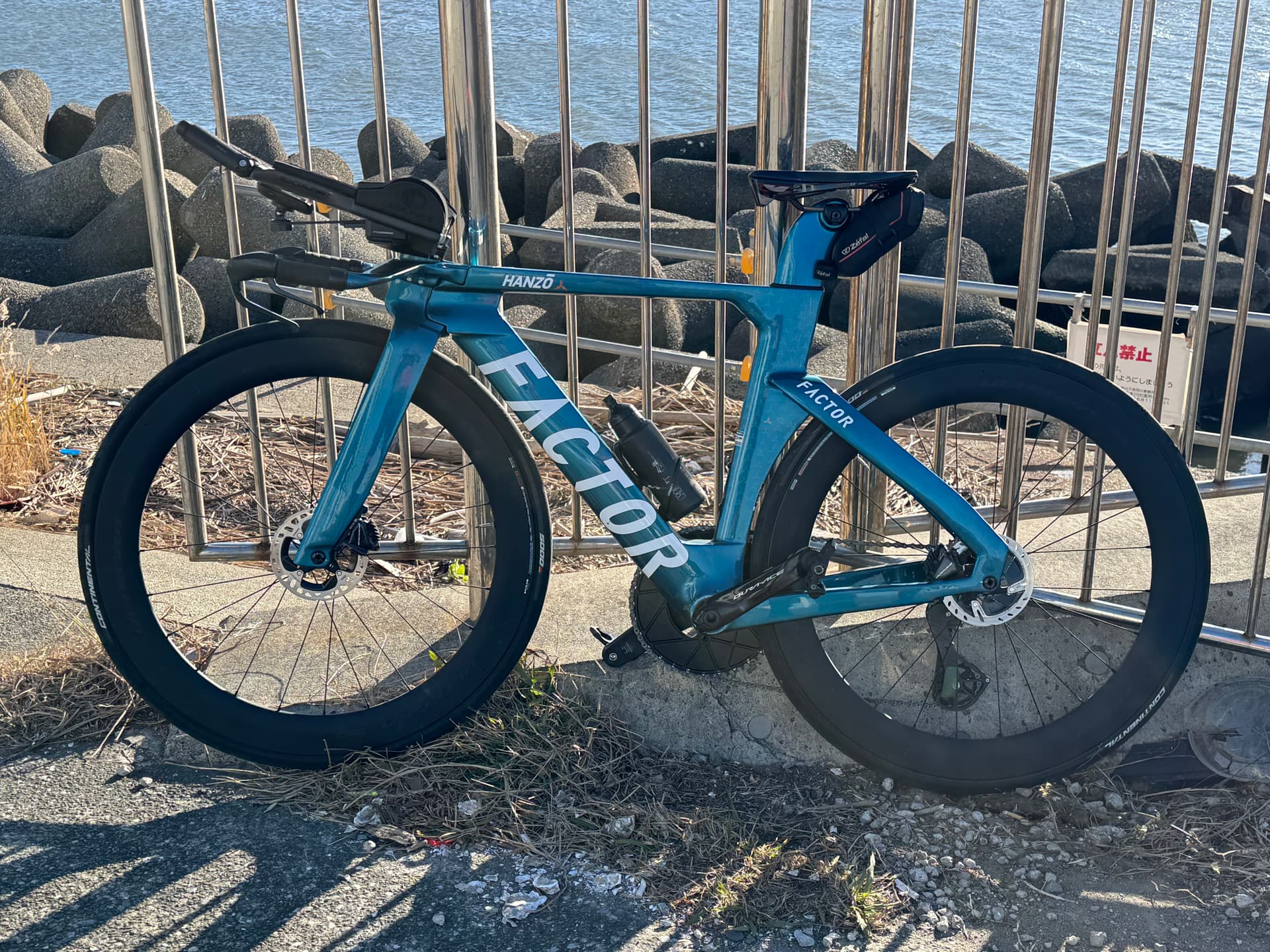

Just got a set from this company in Australia. Recently got a 20% holiday discount
Great bar!
It tested very fast and is quite configurable

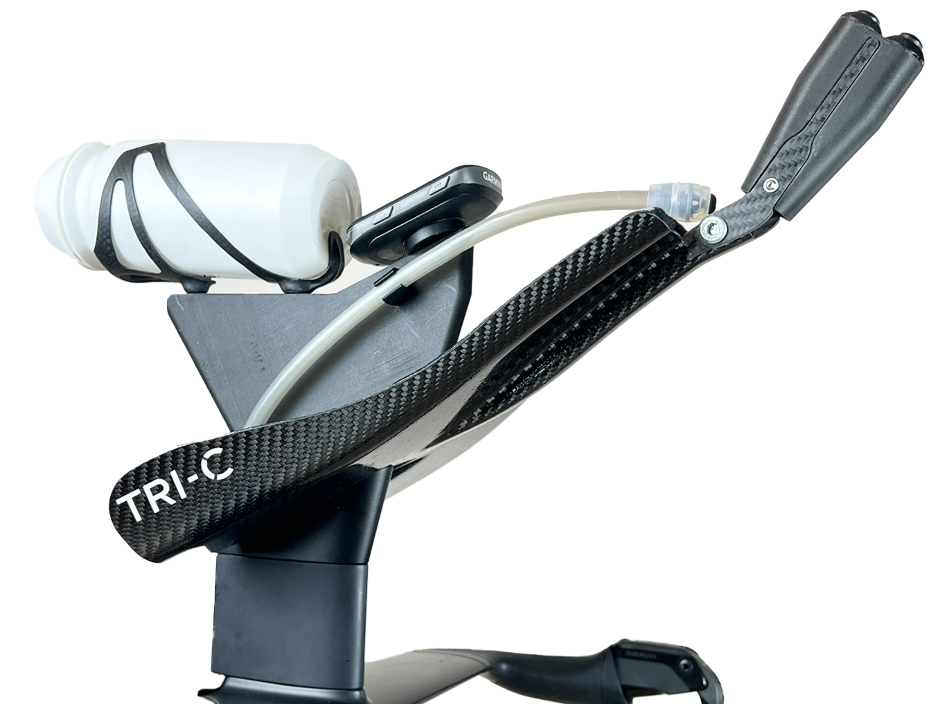

FWIW I have found Evolve Aero (compatible with Trek but I don’t know for Canyon) and then this one:
