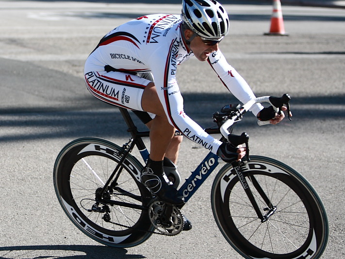

Go big, or go home, I always say… :wink:
http://www.photoscene.com/kimandsteve/images/4639.jpg
