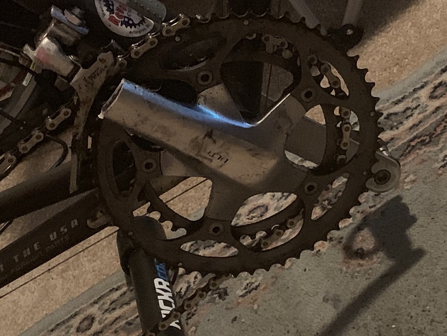

I broke a crank arm today on the trainer. I don’t currently have a powermeter on the bike and am thinking of just getting crank arms with power. I don’t trust the LBS to give me good advice or speedy part ordering so want to make a good decision on a part and then just take it in for them to install.

I would have crashed hardcore if this was on the road… glad it was just on the trainer -

There are lots of ways to can go for a power meter with the easiest being Shimano, since based on your pictures Im guessing you have a shimano 24mm BB, cranksets with stages power meters. They have both dual sided or just left sided power meters.

I would buy a new FC-6600 or FC-6700 crankset on eBay.
Then buy power meter pedals.

How much do you think a LBS would charge to install a FC-6600 right arm only?
Well, if ST holds true, someone will tell you that whatever you replace it with should be shorter. With that in mind, drill and tap the remaining crank arm and you will have pleased the ST community.
You should be able to replace a Shimano crankset yourself in about 5 minutes.
A bike shop would charge about $40.
Do you already have the new crank arm?
Looking at the pictures you posted, particularly the second picture, I’d bet good money that your front derailleur is hitting the inside of the crank arm ever so slightly and scoring it a bit. It appears that the crank arm broke at exactly the same height as where the lower edge off the derailleur cage would hit it. I’ve seen this on a bunch of bikes and you don’t even know it’s doing it unless you look at the inside of the crank arm and see the mark from where it hits with each pedal revolution. Sometimes you don’t even see it hitting if you look a the bike in a work stand but when under load there can be just en9ugh flex in the frame for it to happen. Over time that “scoring” can become a weak point and in the right circumstances can cause the crank arm to fail under load. When you put a new crank on that bike take a close look at this. If the derailleur cage is angled out a bit at the bottom you may see it hitting very slightly. Check the crank arm periodically too see if a mark is showing up.

I ordered a new right crank arm off eBay - it’s going to take 7-10 days to arrive.
Ok thanks for the insight - I’ll have to check this out on the new crank arm to make sure it’s not hitting.
