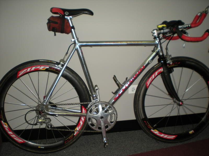

My first “TT” bike is below…and the one that I noted above. 8 spd chain, 9 spd bar end shifters, 10 spd wheels and an 8 spd crank. Worked flawlessly. (9 spd bar end shifters had a “ghost click” that allowed me to run the 10 spd wheels).
Wow. I think some people have different definitions of “flawless”.
The 9spd shifters pull ~10% more cable than 10spd. That isn’t even close. It’s cool if you got it to work ok, but it isn’t going to shift nearly as well as a system that is matched, and will be very finicky needing precise adjustment.

Again, there are technical specs and there are real-world results. I never missed a shift the whole year I ran that system and it was not just “ok”, it was great. In fact, I’d guarantee that if you had ridden the bike, you never would have known that it had 9 spd shifters instead of 10 spd.
Oh, and the RD was an old RX100 8 spd, too.
It’s possible that the derailleur compensated for the cable pull… I don’t know anything about the RX100, but I thought all their indexed derailleurs were the same except for DA 8.
It isn’t rocket science. If your shifter pulls 10% more cable than intended, the derailleur is going to move 10% more than intended. That’s a big error IMO. Even if you set it perfect in the center, you will be off by ~1.9mm at the ends.
