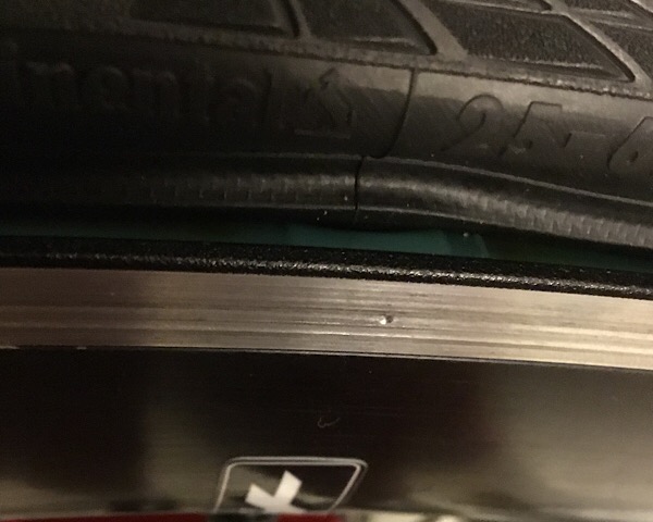

Continental 5000 tubeless on HED Jet Plus rims - What am I doing wrong?
Since I got the fromt tire on both beads sit at the bottom of the wheel centre. At the valve one side is lifted slightly by the valve flange. It can’t be seated with a standard floor pump even with the core removed.
Switching to CO2 I managed to seat the tire with core removed but when I removed the CO2 it popped again and unseated itself. Moving on to CO2 with valve core attached I get the tire to seat properly and it seems to hold pressure, there is a slight leak around the valve, maybe I should replace the tubeless rim tape. The leak is so small The pressure loss is very slow. At this point I can attach the track pump and inflate the tire more. I went up to just below 80 psi witch is the rated maximum pressure according to your homepage.
When letting the pressure out by pressing the valve the tire suddenly popped and the bead was u seated again.
Summar of process
  1. Mount valve - OK
  2. Get one side of tire on - OK
  3. Get other side of tire on - OK
  4. Inflate to seat bead - OK
  5. Let air out - OK
  6. Tore seated withput air - FAIL
  7. Remove core
  8. Add sealant
  9. Replace core
  10. Shake and lay flat and flip
  11. Inflate
This is how tight the tire is:
I managed to get the front tire on by inserting a tire leaver on each end and moving them 1mm at a time. I don’t know how to get them of to fit a standard tire now.
Where am I going wrong? I really want to go tubeless but should I sell these and get a pair of Schwalbe Pro One? When looking at online videos some fit the 5000 TL with out leavers.

My experience with Hed Plus rims is that you have to use a surprising amount of pressure to really get the tires to seat. It varies by tires but 100+ psi isn’t unusual until they really pop (you don’t always hear the final pop but once you know what the seated tire should look like you can see when its sitting correctly). It also isn’t unusual for a tire to get seated 95% of the way around at low pressure and then require a lot more pressure for the final 5%. I think this is just the way the beads are designed on the Plus rims. Once in place they should stay seated unless there is an issue with your particular tire.
I have also found the ease of tire fitting to be very tire specific. Some of the video’s online clearly use tires pre-selected to be easy to fit as they make it look far too easy. I use very stiff Pedro’s levers but have heard good things about the expensive Silca levers. One trick I have used previously is to heat the tires a bit in the drier.
Based on the picture, I think some technique might help. I have not seen any tire that fit so tight that you would need tire levers at the stage in the photo. I HAVE watched people try and put tires on without pinching the bead into the drop center, and they get to the point you show in your photo and can’t go any further. On a TL ready rim, you must keep the beads in the center, no matter what tire.
So - you’re at the point where the photo shows, what’s next? Put your lever in, and pry on the tire but with moderate force, and one hand. You’ll need your other hand free to work around circumference of the rim and squeeze that bead into the drop center. Keep the force applied at the tire lever, and the tool should lever the tire on as you make slack in the bead with the other hand. You might have to take a couple bites with the lever but this will work. The key is to keep the bead in tension so it stays in the middle where you put it. It will take practice. I do the same thing but generally (not always) without the levers - keep tension on that bead so it stays down in the middle. On especially tight tire/rim combos, start your pinch opposite the unseated part and work up one side then go opposite again and work up the other side. As long as you keep tension on the bead you will creep enough slack into it to get the final bit on.

Thank you for your input. I just read your thread regarding tubeless on Hed Jet wheels as well.
I will try using the Schwalbe levers that clip on to the rim that may helt with the getting tire on phase.
I use Hed tubeless valves (that I guess is Schwalbe valves). Since I have used the wheels a lot with tubes the tape is very stretched around the valve hole so I guess I should change the rim tape for new tape when going tubeless. I can’t find any info regarding width of the tape I should use with the Jet plus rim. I found that tubeless tape should be 2-4 mm wider than inner width so should I use a 25mm tape? And then just choose Stans notubes tape or Schwalbe tape?
You don’t need to change the rim tape.
One thing that might help with getting the tire on is to put an old tire and tube in before you install the tubeless valve. New rim tape might not be well seated in the channel yet and old tube and air pressure will compact the tape. It also allows you to check the tape one last time before you try to get the tire on and seated
I have now noticed that the rim tape is poorly mounted and sits where the bead should sit. In my front wheel I have Schwalbe 25mm tape. Is that correct width for the Hed Jet Plus? 21 inside width and 25 on the brake track? Or should I use 23?
Are you using TWO wraps of the supplied HED tape?
I bought the wheels used. The rear disc has a tape that looks like Stans Notubes tape. Probably wrapped twice. I haven’t tried to seat that one. I’ve only worked on my front Jet 6 plus that has blue Schwalbe 25mm tape, wrapped once. On one side I’ve seen the tape folding up on the side so I guess that’s why it won’t seat. The other side looks fine and the bead seats perfectly.
You may consider buying new tape, cleaning and installing 2 wraps of HED’s tape.
It also helps to install the tires with tubes for a day and let the tube set the adhesive on the tape. It all matters and I just did a 244 gravel mile race on HED wheels (Vanquish) this weekend and never lost a single PSI of air. Incredible.
If you replace the rim tape, get it from Hed and eliminate a point of failure. Hed also has (or had) 2 types of rim tape. Beige requires 2 layers, but black only requires one. This info is available in Hed’s FAQs.
I have seen some tires have trouble seating near the valve. You might consider loosening the valve and using it in in a little until you get the tire on, then pull the valve back out and tighten it down.
