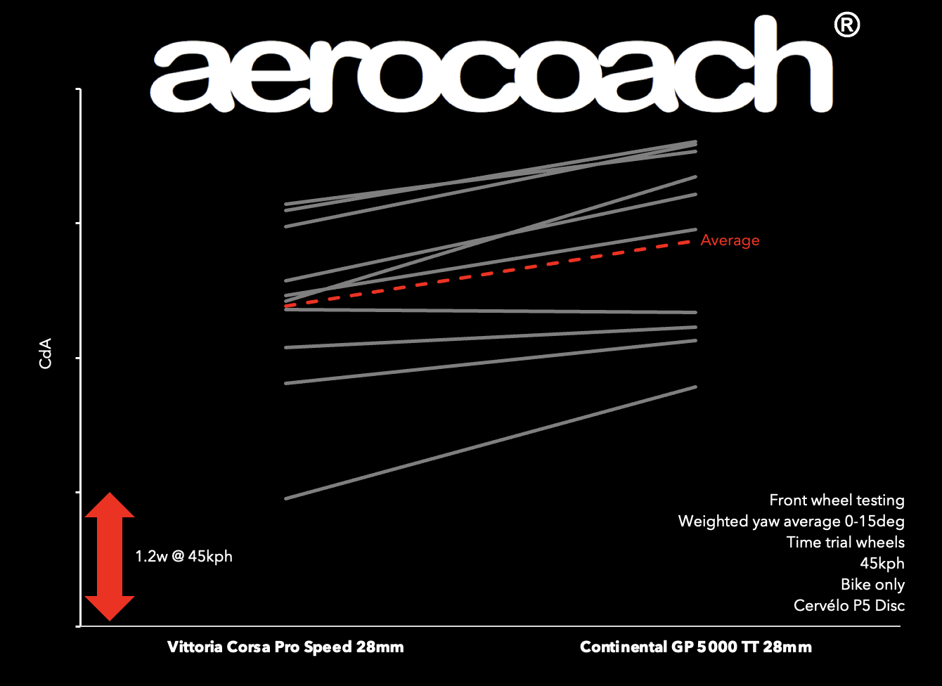

So we’ve been doing a lot of testing recently and I thought this would be of interest, you hear a lot about how Vittoria tyres aren’t aero and Conti are - this was more true in the past as the Corsa Speed (not the Corsa Pro Speed, the older one) was pretty bad for aero but made up for it in Crr vs. the corresponding Conti at the time. The new Corsa Pro Speed has got a totally different construction and is actually pretty good, something we found out a while back when testing the early 24mm on our Titan 100mm wheel.
The data below is from top end time trial wheels, some are multispokes, some are deep sections, internal rim widths ~20-23mm ish, using Conti 5000 TT and Corsa Pro Speed both in 28mm listed size. Because the Conti blows up so wide, it ends up being a good 2-3mm wider than the Vittoria, which in turn makes it on average less aero, using a weighted yaw average from 0-15. The wheel with the flat line in the middle is the only one which is marginally more aero with the Conti, but those data points are well within the margin of error. On one of our 21mm internal wheels, a 28mm Corsa Pro Speed at 90psi is ~28.0-28.2mm, and a 25mm Conti 5000 TT is ~27.0mm, making that a much better comparison. Issue with that is you can’t use a 25mm 5000 TT on a 22mm internal!

Never mind what the listed width of a tyre is, surely to have a reasonable comparison it’s the ‘actual’ width that should be as close as possible. And if that means a conti 25 v a 28 corsa that’s “fair”. Unsurprising the conti 30 (actual) has a larger CdA, dragging it down overall.
As for “can’t use”, again it should be the actual width that matters. So that conti 25 on the 22mm internal rim width would inflate to 27.5 (which is ‘safe’).
Have these points merit?
Worth a thread title amendment btw?
Yes, definitely the end use case is important. From a consumer perspective though you can’t know what things will inflate to, so you have to go by what it says on the tin effectively, and from a company perspective you’re limited by the tyre manufacturer recommendations (if we sold a 22mm internal wheel we can’t allow a 25mm tyre under ETRTO). I think my main point was it’s a bit of a minefield - and that the 25mm GP5000 TT is still an excellent choice as people seem to be moving away from it a little bit from what we can see.

On average, that’s what we saw from this data set across wheels ~20-23mm internal, yes. It won’t be true for absolutely everything I’m sure but in real world use we’ve not seen a Conti 5000 TT beat a Corsa Speed yet, on our wheels at least!

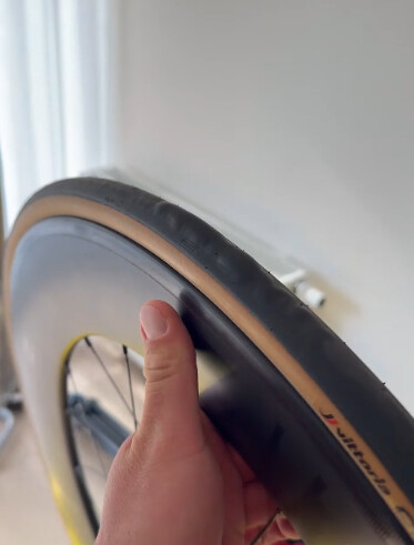

My friend’s tire after 1 month of “standard” using.
This keeps me from buying but seeing those results… :smiley:

That just proves how fast they went :sunglasses:
Do the wear fast or flat easily, which I guess are related.
