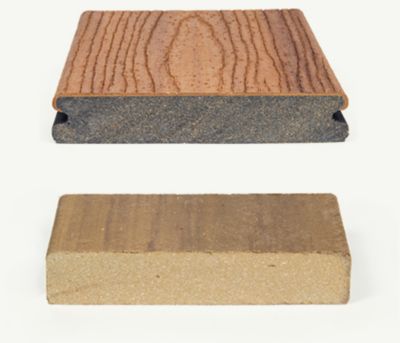

You want to go with a capped product like Trex. I put in dark moisture shield at my old house and didn’t have any issues, but in my new house the former owner put in a light colored moisture shield and it gets stained. A capped product is incredibly difficult to stain.

You can go with a light color if you use a capped product. However, if you go light on something without that extra layer of protection it will stain and fade. I was thinking of flipping some of the stained boards over, but then the color won’t match the other boards that have seen a three or four years of sun.
