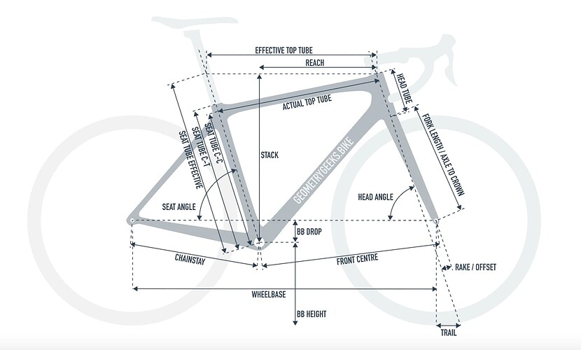

I’m in the market for a new road bike. Exciting! I had a recent fit session that gave me numbers that represent what would be optimally efficient for me. Now I can hunt for a bike. But looking at the geometry charts of various bikes it’s not clear how to take my fit numbers and apply them to one bike vs. another.
Specifically, using a standard diagram like this one (from geometrygeeks), I want to take my optimal “distance from saddle to brake hood” number and apply that to various frames. How do I determine that based on knowing a bike’s top tube length?
I also have my “optimal saddle height (x) number” based on my current bike’s geometry. So I could figure out how much or little seat post would be showing on a different frame by adding ‘x’ to that bike’s seat tube distance. But that is optimal if the seat angle is the same. How might I compare things if the seat angles differ? And I think this needs to relate to the reach measurement above.

The charts from manufacturers aren’t always super accurate and I don’t know of good free tools to project frame stack/reach into fit coordinates. Best bet is to use the frame coordinates to get you close as try before you buy (not always possible)
There are free tools
https://app.velogicfit.com/frame-comparison
For anyone getting a fit to purchase a bike, the fitter should be supplying handlebar XY (for road bikes) along with the bar spec. If they’re not working to XY there is a reduced likelihood that your target position will be achieved.
Looks like the XY Bike Calc tool would be very useful.
Yes, my fit session gave me handlebar x/y, and saddle x/y numbers as well. Both before (current) and after (optimal). Looks like the calculator can convert those x/y’s to stack and reach; and then I can enter those stack and reach answers to get a list of bikes that would fit me. Nice!
edit - to enter my x/y numbers requires a subscription signup. argh. Will look into the free two week trial.

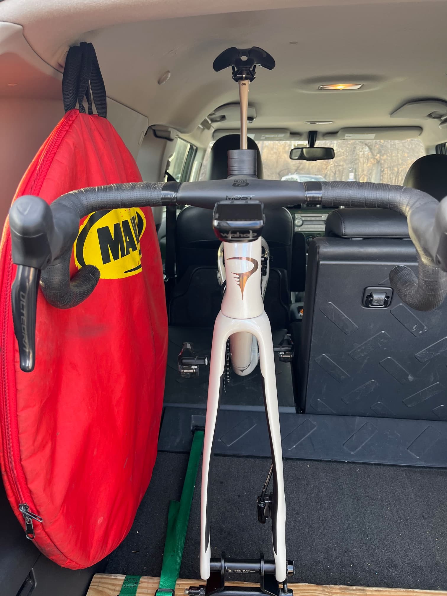

Since you asked…
This makes me smile. Both pre and post-ride.
I fit the bike perfectly. Bike fits into the FJ perfectly… It’s all good.

The bike has an Ultegra drive train. Computer is Wahoo.
On my to do list is to download and check out the E-Tube app which I hear will allow me to check battery life, (re)program shifters if nec, have some additional info displayed on my Wahoo display, and some other cool stuff.
If ultegra then that’s got the battery in the seattube (charged from the rear derailler). You can press the button on the rear mech and the flashes tell you the battery level. But you’ll really only need to charge every 3 months or so….
