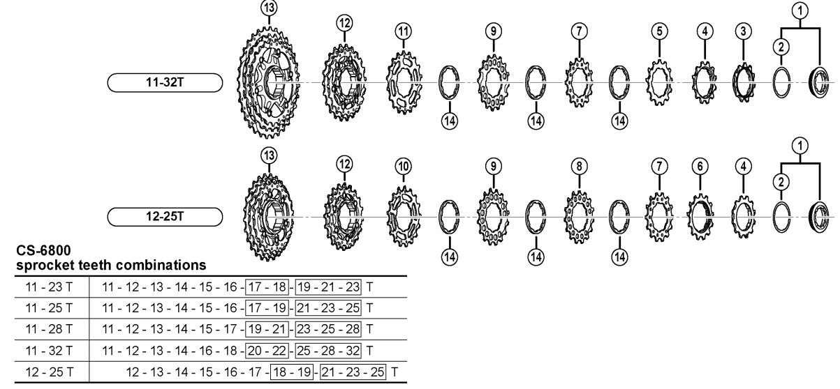

Combine 11sp 12-25 and 11-32 cassettes
I need a climbing cassette with both a 15 and 16 cog in it.
Will this work? Looks like it would be pretty straight fwd…
12-25: 12-13-14-15-16-17-18-19-21-23-25
11-32: 11-12-13-14-16-18-20-22-25-28-32
My cassette:
12-32: 12-13-14-15-16-18-20-22-25-28-32
The 12-25 has an “A” code 16T cog, while the 11-32 has a “B” code 16T cog. The difference is the shift ramp machining. While you’re Frankencassette will probably work OK, you might experience some less than smooth shifting either way at the crossover point.
I have done it and what gary p says is correct.
There’s a lot of that type of thing in mixing and matching cranks, chains, and cassettes, as well as mixing 10 and 11 sp parts, and sometimes while mixing SRAM and shimano. It will probably work, but all matched parts have those shift ramps machined for best shifting.
As far as I can tell, Shimano doesn’t make a 16T 11-speed cog with shift ramp machining for a one-tooth step on the high side and a two tooth step on the low side. It’s either 1 tooth step both ways (A-code) or 2 tooth step each way (B-code).
Not sure exactly what you’re trying to accomplish, but maybe you could get there with the new Ultegra 11-30 cassette and going down in size on the front chainrings. No 16T on that, but the 5 smallest cogs (11-15) are in single tooth steps. With 2T smaller front rings, the drive ratio with the 15T is awfully close to what the it is with the bigger chainrings and the 16T. Same with the 30/32T biggest cogs.
