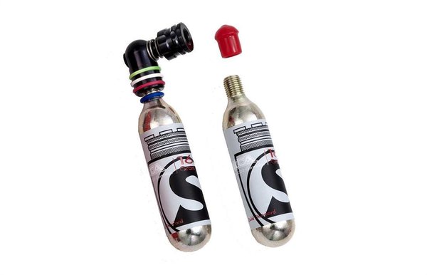

Lots of folks have good things to say about the Silca one: https://www.backcountry.com/silca-eolo-iii-c02-regulator?CMP_SKU=SLC000Z&MER=0406&skid=SLC000Z-ONECOL-ONESIZ&mr:trackingCode=1F2C53D7-01E3-E611-80FD-005056944E17&mr:referralID=NA&mr:device=c&mr:adType=plaonline&iv_=__iv_p_1_g_49514702840_c_224495893170_w_pla-388894472781_n_g_d_c_v__l__t__r__x_pla_y_7811_f_online_o_SLC000Z-ONECOL-ONESIZ_z_US_i_en_j_388894472781_s__e__h_9031914_ii__vi__&CMP_ID=PLA_GOc001&utm_source=Google&utm_medium=PLA&k_clickid=_k_EAIaIQobChMI8u7oyt2Q8gIVAz2tBh00VQElEAQYASABEgKhXvD_BwE_k_&utm_id=go_cmp-213416677_adg-49514702840_ad-224495893170_pla-388894472781_dev-c_ext-_prd-SLC000Z-ONECOL-ONESIZ&gclid=EAIaIQobChMI8u7oyt2Q8gIVAz2tBh00VQElEAQYASABEgKhXvD_BwE
https://www.sefiles.net/merchant/3358/images/large/Silca_Eolo_III_Kit.jpg
