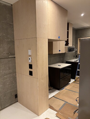

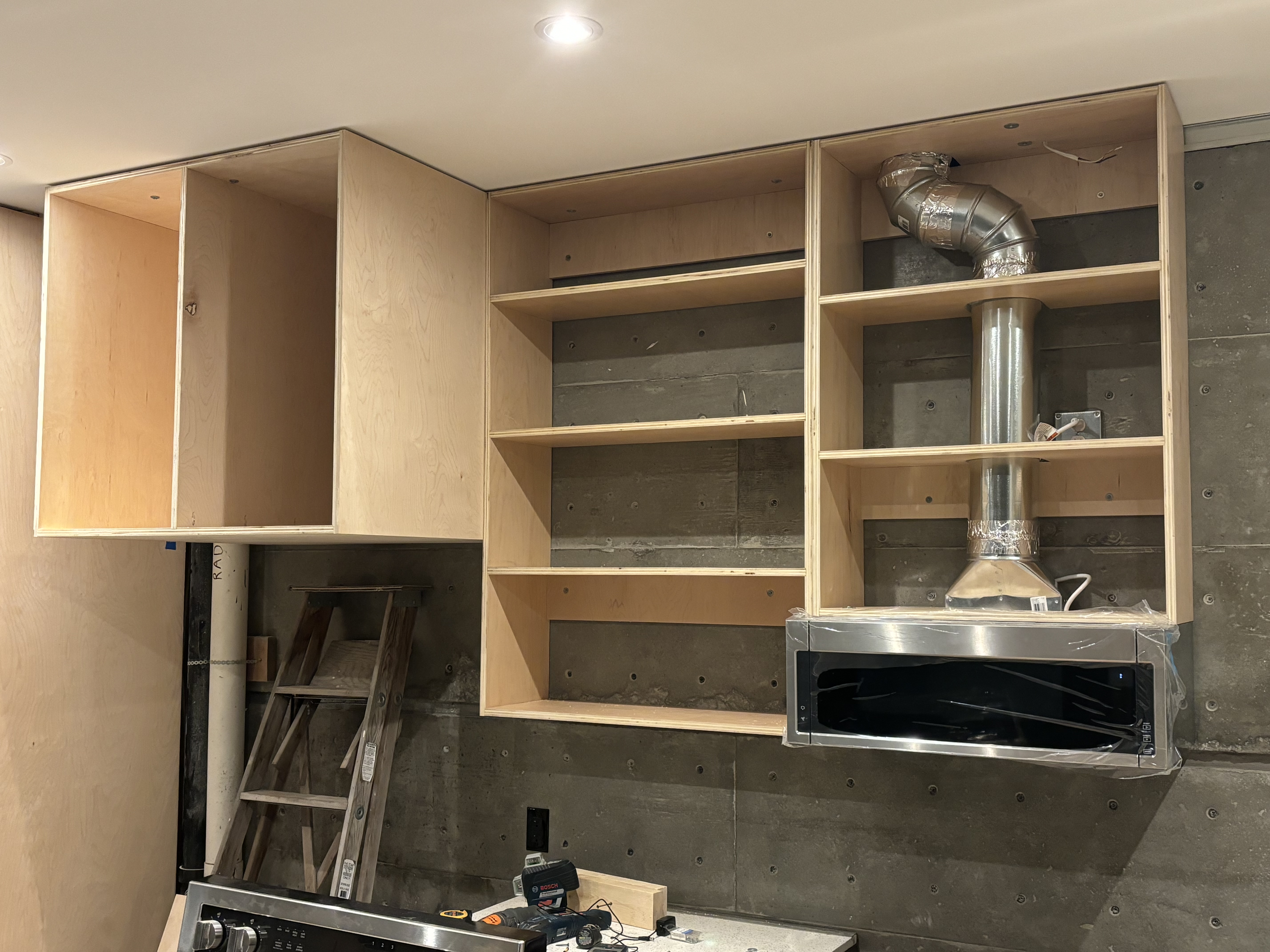

Unrelated but I started a thread a while back about track saws and ended up with the festool for my cabinet uppers. Expensive but extremely happy for 3/4 sheet goods:
ETA I believe I went with your recommendation which was festool.
Very cool. Although I’m upset you couldn’t line up the lines of the cabinets to the left of your fridge with the form ply lines of your walls ;-). Would love to see some pictures of how it looks finished.

Yes, this is just rough mounting. So I have to take everything off and 4x light coats of diamond finish sanded 220 between…also there was a problem where I basically wrecked a sheet due to mis measure, so unfortunately grains didn’t line up the way I wanted. Also two boards need a 1/8 trim to match the shadow detail on the wall.
But I guess if you look at that I have 1300$ in saw plus accessories and 500$ in materials. Another 300$ in Kregs stuff.
Not perfect but super happy for my first go.
