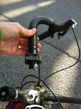

http://www.kybikerides.org/images/2011-11-17-@12-15-32-Broken-Bar.jpg
http://cdn.cyclingforums.com/a/ae/350x263px-ae00cd45_7178995072_117da2c979.jpeg
Yeah, the only bar I’ve ever seen break was aluminum. It just snapped, I was riding with him when it happened. Required a ride to the hospital for some stitches, luckily nothing worse as he wasn’t going that fast. I will say he was a very big and strong guy. The bar in question was a couple seasons old. This was quite a few years ago when we still used the old style quill stems and bars had a reinforcing sleeve in the center. Most people didn’t use torque wrenches back then but the design of the stems meant it was harder to overtorque the stem as it was a pinch bolt design rather than a two piece clamp.
That top one looks like an over-tightened clamp…
