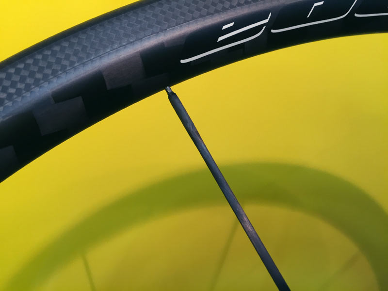

https://www.bikerumor.com/2015/09/17/ib15-sapim-cx-carbon-spokes-bring-full-composite-construction-to-wheel-building/
https://www.bikerumor.com/wp-content/uploads/2015/09/sapim-CX-carbon-fiber-spoke04.jpg
So these cloth spokes for training and the carbon ones for racing sounds pretty nice. Thanks for sharing!
Bonded composite joints are very strong. Considering how it’s loaded, I would be no less confident in its strength than an ordinary spoke. My only issue with these is that they’d be easily damaged from direct impacts on the spokes, so definitely better to use on race day only wheels.
