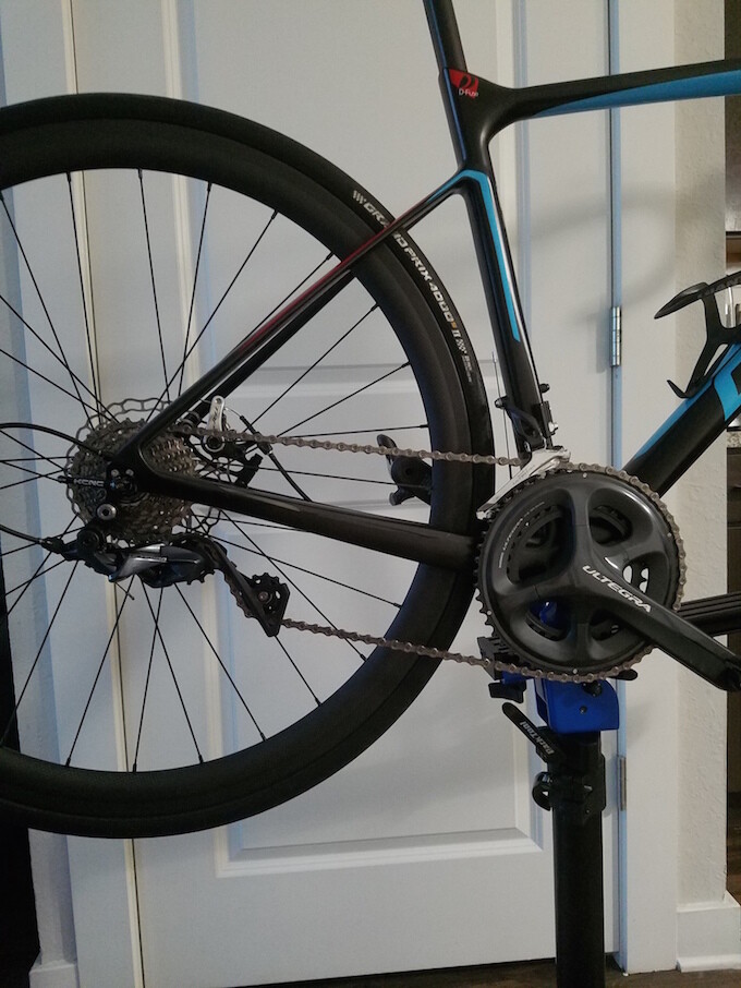

Chain too short? Pics attached
Not having cut or fit a new chain to a bike, I had a bike shop do it to avoid screwing it up.

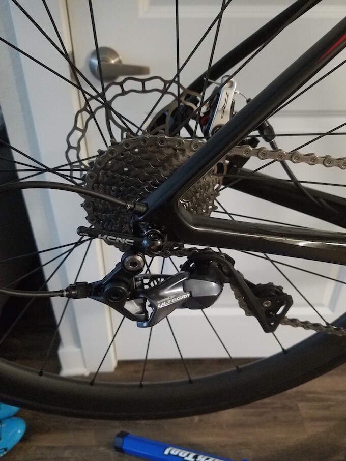

I installed a new RD (Ultegra R8000), recabled the bike and had the shop install the chain and index the gears (even though I did it again myself). The issue I have is that I can barely shift into the largest rear cog. And when I do, the chain is grinding horribly (can’t even pedal) on the lower pulley when in the Big Ring. I’ve never had this issue before. So my question is, looking at the cage/pulley position when in Big Ring and 2nd Largest Cog (can barely get into the largest), is the chain cut too small? The cage looks awfully horizontal than I’m use to seeing it.
IMO it is to short.
looks too short to me
I’ve never seen a derailleur near horizontal before - looks very short to me.
Yes, it’s too short. Need a link (pair) in there and then it should be good.
I think it’s too short. Although cross chaining is not great, you are more likely to use the big-big combo over the small-small combo, so erroring on the side of a bit too long of a chain is better.
Side note: I recommend flipping around that skewer so the clamping lever is on the rotor side of your bike. A fallen or jammed chained is much more likely to open the lever.
Too short. I use the small/small method when sizing a chain. Place the chain on the smallest cog and the small chainring (assuming a double), then remove just enough links that the rear derailleur cage doesn’t fold over and hit the chain. Sanity check to make sure you can still shift into the large chainring and second largest cog without it looking like your bike looks now .
OH YEAH - waaaay too short - hope the bike shop give you a new chain
thank you for the responses…too short it is. i know it’s not ideal to ever be in this combo of big ring big cog, but it still bothers me that I can’t make use of all gears. i will add another link and go from there - I could’ve messed it up doing it, but not acceptable to pay for something like this.
Another one the ‘way too short’ vote.
Put it on big + big then should have 2 ‘spare’ links min (ie able to make a small ‘fold’ in the chain.)

Can the cage still swing out a little? If so, it is technically OK. The chain is making contact at several points along both jockey wheels. Maybe they thought you wanted a super weight weenie setup and made the chain as short/light while still being functional?
However, that looks like a pretty close stacked cassette. You would not be able to swap on something bigger if needed.
So, like above, I fit mine to the little-little and make sure the RD is a little under tension and the cage arms don’t touch. I just make sure to do that on an 11-25 cassette. That way, it is a little heavier, but I can put on a 28 or 32T cassette and it’ll be OK.

You are at least 4 links too short.
Did the bike shop put the skewer on backwards too?
I was thinking 4 links as well.
He’d probably rip the rear derailleur if he accidentally shifted into the largest sprocket.

I suspect it’s too short as well. Your GS cage makes me lean in that direction.
But, to know for sure, I’d like to see a pic with the chain on the small ring and the big cog. If the derailleur can’t take up any more chain, then the chain is as long as it can be. If there’s still room, then the chain is too short.
That chain is definitely too short. I fear for the longevity of your derailleur if you try to shift up to the largest cog. At best it just won’t shift, at worst it’s going to rip the thing right of the bike.
Maybe it was just a mistake, maybe it was an inexperienced person doing the work, or maybe the shop just sucks, but they owe you a new chain.

That is so obviously wrong that any casual glance at the bike from anybody in the shop would have spotted it.
I don’t know any mechanic that would not run through big/big and small/small combination to confirm length.
I wouldn’t even take it back to the shop involved and go somewhere else if this is really shop work.
+1 for too short.
What ratio cassette are you running?
I have the Ultegra R8000 short cage rear mech and can just run the Ultegra 11-30 cassette.
As someone mentioned above, take a pic with it in the small-small combo and see how it looks. I always start there when I’m sizing up a new setup.
