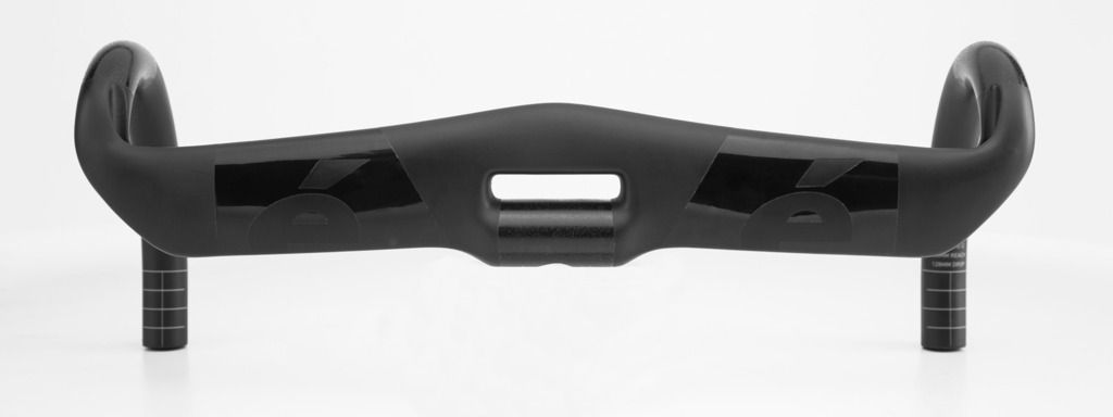

have a 2015 cervelo s5 with them fancy aerobars, which i actually do like except…
it seems that i have to choose between either mounting a light or my garmin edge 510. does anyone have a solution to mounting both? and yes, i have searched google and this site, but most of the solutions only solve either a light or a garmin - i want bothhhhhhhh

How exactly is that mount going to work with his bars?
http://i42.photobucket.com/albums/e344/refthimos/Cervelo_New_S5_complete_aero_road_bike_Aero_Road_Bars_top_view_zpsx7yhehff.jpg
I would recommend this mount - I use it with my Enve SES road bars (which have a very narrow round clamp area) and Zipp Sl Sprint stem (which had a very wide clamp), as there is zero round area available for mounts. Works well. The underneath attachments are interchangeable so you should be able to get one that works with you particular light.
