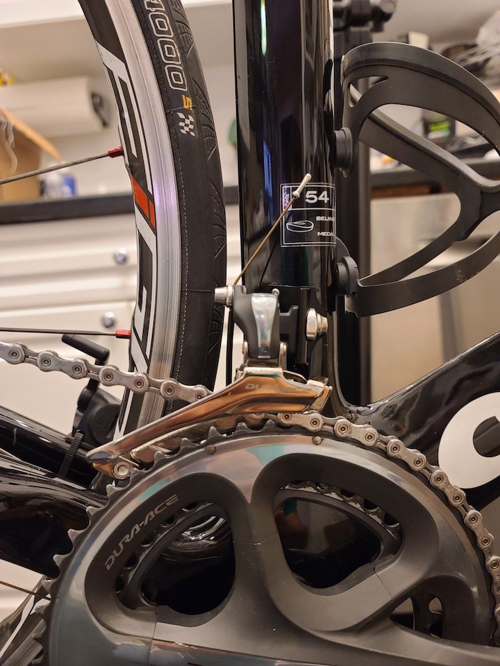

I ended up using m3 aluminum rivnuts prepped with alodine and alumniprep, and bonded with araldite 2015. Aditional araldite 2015 was added behind the front derailleur mount. The original mounting holes were slowly sanded by hand with a diamond hand file. I also needed to replace the front mount with a new once since the old was so bent out of shape from the force. Finally I replaced the cable – the old one was frayed thrashed.
Tools & parts I used:
Alodine: https://www.aircraftspruce.com/...pnpages/09-01628.phpAlumniprep: https://www.aircraftspruce.com/...pnpages/09-01621.phpAraldite 2015: https://www.amazon.com/...dt_b_product_details5mm hand files: https://www.amazon.com/...uct_details&th=110mm hand files: https://www.amazon.com/...uct_details&th=1Hand rivet nut kit: https://www.amazon.com/...dt_b_product_detailsM3 Aluminum rivet nuts: https://www.amazon.com/...uct_details&th=1
Photos of the process and end results are attached.
